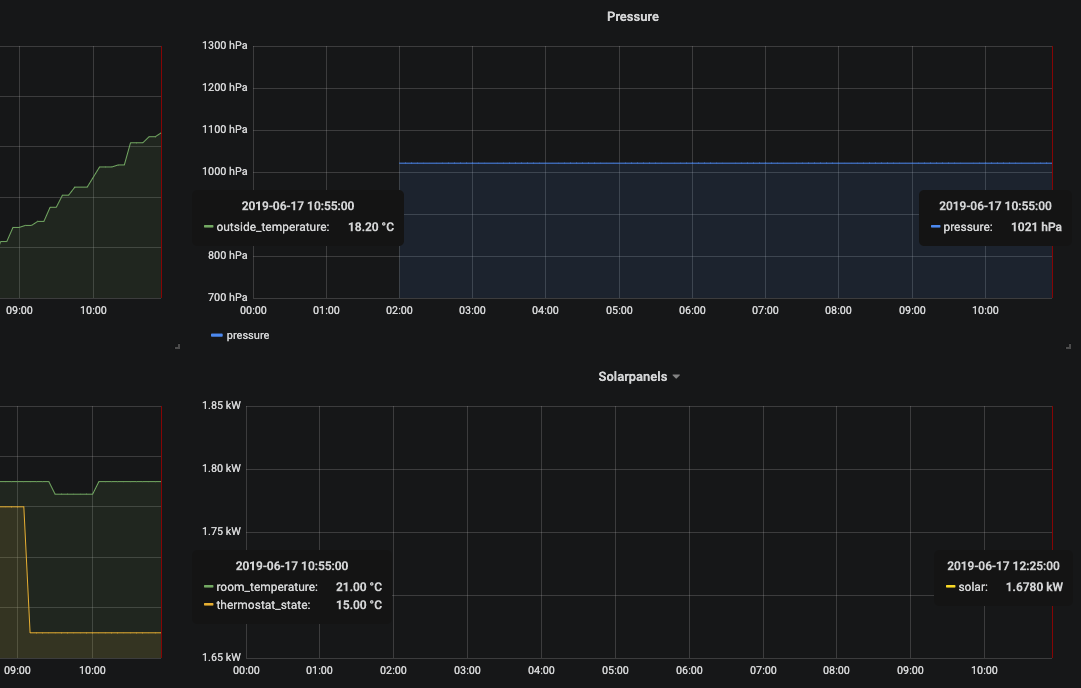

I live in +2:00 timezone. Both my server and clients are in the same timezone. I feel this is the simplest possible scenario if the MySQL+Grafana are expected to work together, but I haven’t been able to resolve the timezone issue.

My plots are still missing 2 hours, although the current value is being shown at the correct time.

Look at this:
Having
SELECT UNIX_TIMESTAMP(time) AS “time”, …
shifts everything back 2 hours in time.
I guess now if I don’t shift time when I insert records, everything should be fine.
I mean, again, this is just the basic functionality. I was expecting it to work out of the box. Are all the developers and testers sitting nex to the Big Ben? :slight_smile:
