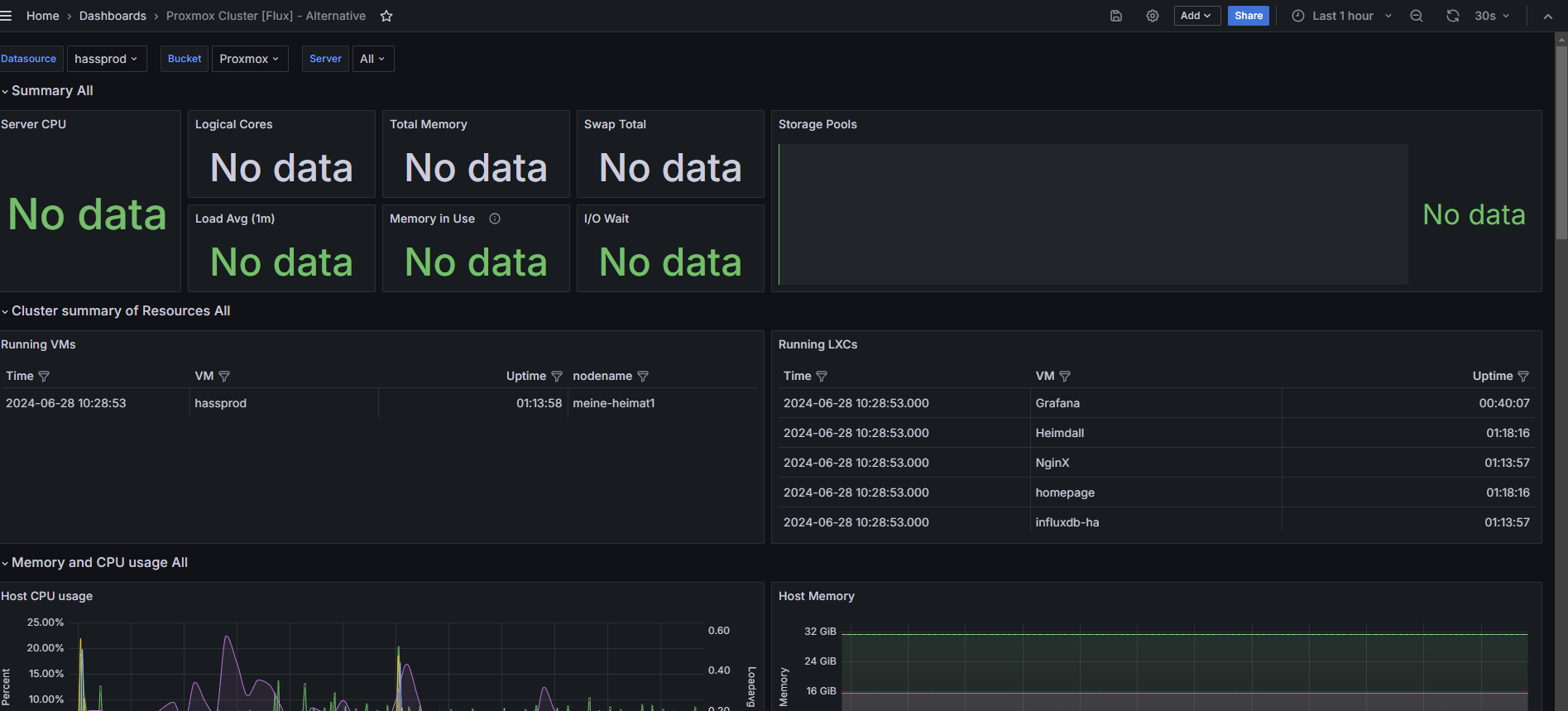

Grafana dashboard ID15356 broke after Proxmox Kernel 6.8.8.2 update
After upgrading my Proxmox Cluster to the newest Kernel 6.8.8.2 because of an issue with the Grafana LXC (kept running but IP was not accessable anymore / same with influx LXC) the dashboard is not complete anymore. It is like it is not able to get the server selection right. If I for example select a specific node in CPU Visu it shows the data. The complete data is also shown in influxdb itself. So it myst be some kind of syntax or recognize problem in the dashboard, but I am not getting it. VM Visu is broken aswell. Some ideas for adjustment?

Same here ! - only after the Grafana Docker was updated (grafana/grafana:latest Linux/amd64)
I think the data source query format has changed ?. I can get some ‘icons’ working by re-copying the query from Influxdb but only a few.
Let’s hope either ID15356 gets updated or Grafana get fixed
Looks like the regex and server notation in the querys ist getting empty results. When i added the nodes one by one I get some information though.I rearranged it for now, but would be great to be fixed.

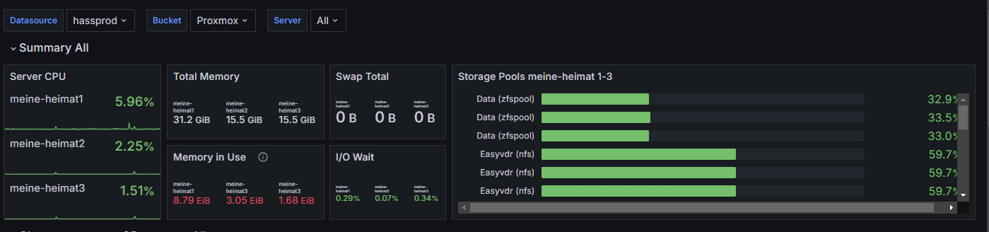

Mine looks like this now.

Thanks. Rearranged it with this information a little bit. Call it optimization :wink:
