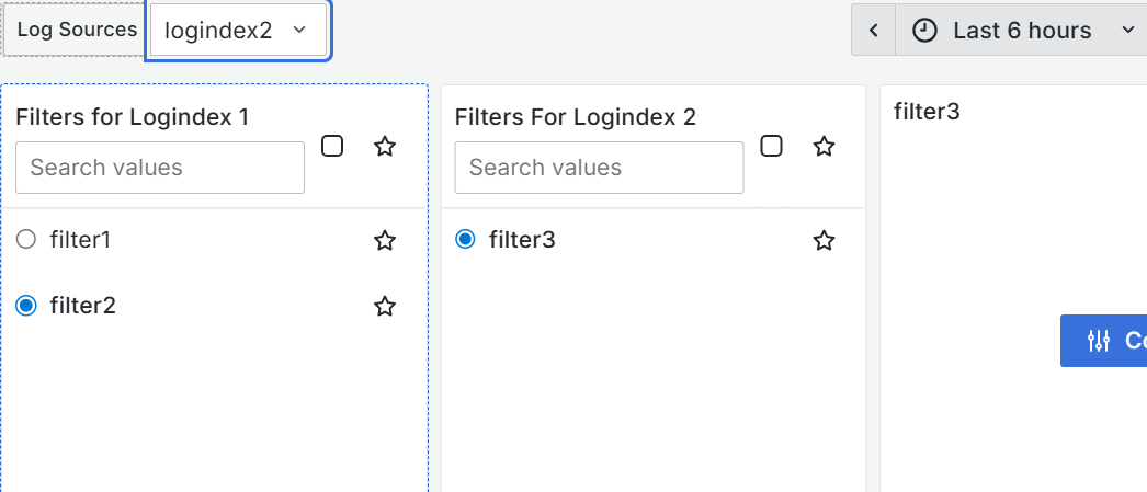

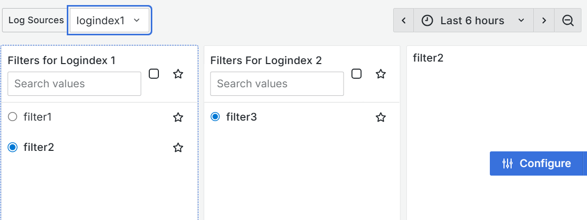

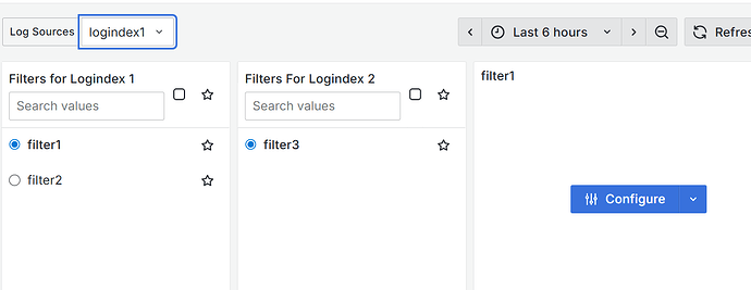

Thanks for the quick response. However for me the space is present, but it doesn’t work.

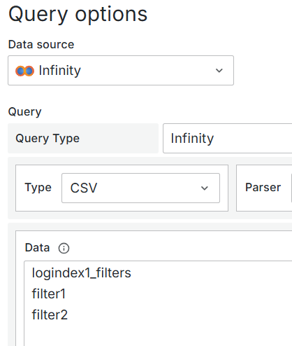

Could you show me your config of $FiltersForLogindex1? Also: What did you use to display the filters as radio buttons?
After some more trial-and-error I discovered that the issue goes away when I configure $FiltersForLogindex1 without the “Include All option” (which I need however and which seems enabled in your case). If this option is enabled however the preview for $LogSources looks like this
@yosiasz: Mine is not the solution, it doesn’t work. Could you show your configuration of $FiltersForLogindex1? Also: What did you use to display the filters as radio buttons?
I am using Business Variable plugin
