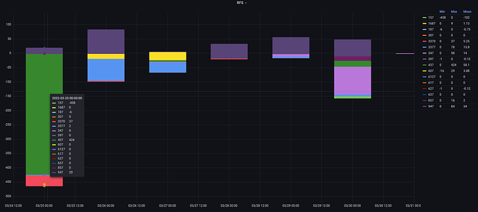

I have a stacked bar chart and negative values don’t stack with positive ones. I use Graph(old) and Time series both of them does not work properly with negative value.
Here is Graph(old). Staking is set to normal.

And here Time series, with the same problem.

It is Grafana 8.3.6, can’t check it on early one
I found several similar topics, but none of them have a solution.
Best regards
Vladimir
have you searched for issues in the repo? I think there is a discussion somewhere about stacking negative values…
