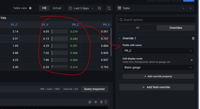

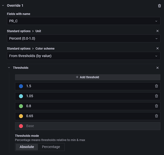

Ran into the same issue. I was able to get it working in a test environment by changing the field type to String instead of Numeric.
Your figures are too low.
Multiply with 100 and use Percent 0-100 as a unit
(max(hz_memory_usedHeap{mc_member!=“”}) by (mc_member,mc_cluster)/max(hz_memory_maxHeap) by (mc_member,mc_cluster))*100
Ps: I am using Grafana v8.3.6 (bf8766bbf2)
