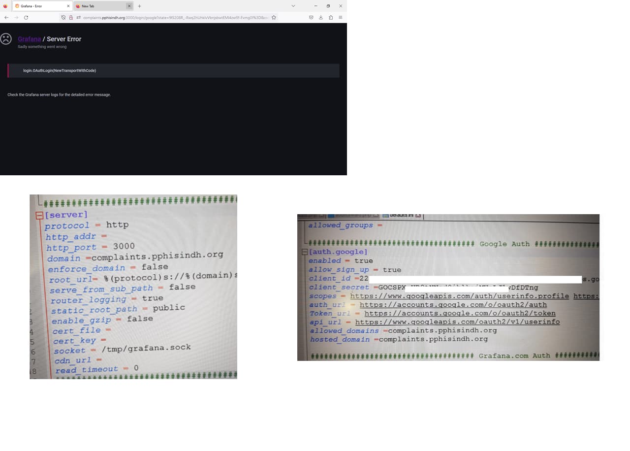

Hello Guruz,
I find myself facing an issue where I’m attempting to connect my locally hosted Grafana instance with Google authentication. I’ve followed all the necessary steps attentively, but I’m struggling to pinpoint where I might be making a mistake.Below, you can find my server and Gmail OAuth configurations.
Please follow instruction on your screen: check the Grafana server logs
Dear,
nothing much visible in logs please check below.

logger=context traceID=00000000000000000000000000000000 userId=0 orgId=0 uname= t=2023-10-05T09:13:01.7786724+05:00 level=error msg=“Request error” error=“runtime error: invalid memory address or nil pointer dereference” stack=“/usr/local/go/src/runtime/panic.go:221 (0xff091c)\n/usr/local/go/src/runtime/signal_windows.go:254 (0xff08ec)\n/drone/src/pkg/api/response/web_hack.go:45 (0x1c90b9a)\n/usr/local/go/src/reflect/value.go:556 (0x1096ae4)\n/usr/local/go/src/reflect/value.go:339 (0x1096064)\n/drone/src/pkg/web/inject.go:159 (0x1afe286)\n/drone/src/pkg/web/inject.go:119 (0x1afded4)\n/drone/src/pkg/web/context.go:71 (0x1afd16b)\n/drone/src/pkg/web/context.go:66 (0x1b04fba)\n/drone/src/pkg/web/macaron.go:141 (0x1b04fac)\n/usr/local/go/src/net/http/server.go:2047 (0x12768ee)\n/drone/src/pkg/middleware/csp.go:22 (0x23b6a72)\n/usr/local/go/src/reflect/value.go:556 (0x1096ae4)\n/usr/local/go/src/reflect/value.go:339 (0x1096064)\n/drone/src/pkg/web/inject.go:159 (0x1afe286)\n/drone/src/pkg/web/inject.go:119 (0x1afded4)\n/drone/src/pkg/web/context.go:71 (0x1afd16b)\n/drone/src/pkg/web/context.go:66 (0x1b04fba)\n/drone/src/pkg/web/macaron.go:141 (0x1b04fac)\n/usr/local/go/src/net/http/server.go:2047 (0x12768ee)\n/drone/src/pkg/web/render.go:44 (0x1affd66)\n/usr/local/go/src/reflect/value.go:556 (0x1096ae4)\n/usr/local/go/src/reflect/value.go:339 (0x1096064)\n/drone/src/pkg/web/inject.go:159 (0x1afe286)\n/drone/src/pkg/web/inject.go:119 (0x1afded4)\n/drone/src/pkg/web/context.go:71 (0x1afd16b)\n/drone/src/pkg/web/context.go:66 (0x1b04fba)\n/drone/src/pkg/web/macaron.go:141 (0x1b04fac)\n/usr/local/go/src/net/http/server.go:2047 (0x12768ee)\n/drone/src/pkg/middleware/csrf.go:21 (0x23b6e8f)\n/usr/local/go/src/reflect/value.go:556 (0x1096ae4)\n/usr/local/go/src/reflect/value.go:339 (0x1096064)\n/drone/src/pkg/web/inject.go:159 (0x1afe286)\n/drone/src/pkg/web/inject.go:119 (0x1afded4)\n/drone/src/pkg/web/context.go:71 (0x1afd16b)\n/drone/src/pkg/web/context.go:66 (0x23b9fca)\n/drone/src/pkg/middleware/recovery.go:168 (0x23b9fc1)\n/drone/src/pkg/api/response/web_hack.go:49 (0x1c90ad3)\n/usr/local/go/src/reflect/value.go:556 (0x1096ae4)\n/usr/local/go/src/reflect/value.go:339 (0x1096064)\n/drone/src/pkg/web/inject.go:159 (0x1afe286)\n/drone/src/pkg/web/inject.go:119 (0x1afded4)\n/drone/src/pkg/web/context.go:71 (0x1afd16b)\n/drone/src/pkg/web/context.go:66 (0x23b7b44)\n/drone/src/pkg/middleware/logger.go:35 (0x23b7b30)\n/drone/src/pkg/api/response/web_hack.go:31 (0x1c90e34)\n/usr/local/go/src/reflect/value.go:556 (0x1096ae4)\n/usr/local/go/src/reflect/value.go:339 (0x1096064)\n/drone/src/pkg/web/inject.go:159 (0x1afe286)\n/drone/src/pkg/web/inject.go:119 (0x1afded4)\n/drone/src/pkg/web/context.go:71 (0x1afd16b)\n/drone/src/pkg/web/context.go:66 (0x23bacaf)\n/drone/src/pkg/middleware/request_metrics.go:60 (0x23bac9e)\n/drone/src/pkg/api/response/web_hack.go:31 (0x1c90e34)\n/usr/local/go/src/reflect/value.go:556 (0x1096ae4)\n/usr/local/go/src/reflect/value.go:339 (0x1096064)\n/drone/src/pkg/web/inject.go:159 (0x1afe286)\n/drone/src/pkg/web/inject.go:119 (0x1afded4)\n/drone/src/pkg/web/context.go:71 (0x1afd16b)\n/drone/src/pkg/web/context.go:66 (0x23bc439)\n/drone/src/pkg/middleware/request_tracing.go:60 (0x23bc428)\n/drone/src/pkg/api/response/web_hack.go:31 (0x1c90e34)\n/usr/local/go/src/reflect/value.go:556 (0x1096ae4)\n/usr/local/go/src/reflect/value.go:339 (0x1096064)\n/drone/src/pkg/web/inject.go:159 (0x1afe286)\n/drone/src/pkg/web/inject.go:119 (0x1afded4)\n/drone/src/pkg/web/context.go:71 (0x1afd16b)\n/drone/src/pkg/web/router.go:156 (0x1b015dd)\n/drone/src/pkg/web/router.go:223 (0x1b02271)\n/drone/src/pkg/web/macaron.go:176 (0x1aff6b0)\n/usr/local/go/src/net/http/server.go:2879 (0x1279e5a)\n/usr/local/go/src/net/http/server.go:1930 (0x12759c7)\n/usr/local/go/src/runtime/asm_amd64.s:1581 (0x100eba0)\n”
logger=context traceID=00000000000000000000000000000000 userId=0 orgId=0 uname= t=2023-10-05T09:13:01.7786724+05:00 level=info msg=“Request Completed” method=GET path=/login/google status=302 remote_addr=202.69.56.91 time_ms=29 duration=29.3876ms size=479 referer=http://complaints.pphisindh.org:3000/login traceID=00000000000000000000000000000000
logger=oauth t=2023-10-05T09:13:02.4236684+05:00 level=info msg=“state check” queryState=1a08a2d8fcae6d52f0272f309684dbe4b69e3cc9d044cbe3cd56c2c460582642 cookieState=1a08a2d8fcae6d52f0272f309684dbe4b69e3cc9d044cbe3cd56c2c460582642
logger=context traceID=00000000000000000000000000000000 userId=0 orgId=0 uname= t=2023-10-05T09:13:02.4246526+05:00 level=error msg=login.OAuthLogin(NewTransportWithCode) error=“Post "": unsupported protocol scheme ""”
logger=context traceID=00000000000000000000000000000000 userId=0 orgId=0 uname= t=2023-10-05T09:13:02.4367734+05:00 level=error msg=“Request error” error=“runtime error: invalid memory address or nil pointer dereference” stack=“/usr/local/go/src/runtime/panic.go:221 (0xff091c)\n/usr/local/go/src/runtime/signal_windows.go:254 (0xff08ec)\n/drone/src/pkg/api/response/web_hack.go:45 (0x1c90b9a)\n/usr/local/go/src/reflect/value.go:556 (0x1096ae4)\n/usr/local/go/src/reflect/value.go:339 (0x1096064)\n/drone/src/pkg/web/inject.go:159 (0x1afe286)\n/drone/src/pkg/web/inject.go:119 (0x1afded4)\n/drone/src/pkg/web/context.go:71 (0x1afd16b)\n/drone/src/pkg/web/context.go:66 (0x1b04fba)\n/drone/src/pkg/web/macaron.go:141 (0x1b04fac)\n/usr/local/go/src/net/http/server.go:2047 (0x12768ee)\n/drone/src/pkg/middleware/csp.go:22 (0x23b6a72)\n/usr/local/go/src/reflect/value.go:556 (0x1096ae4)\n/usr/local/go/src/reflect/value.go:339 (0x1096064)\n/drone/src/pkg/web/inject.go:159 (0x1afe286)\n/drone/src/pkg/web/inject.go:119 (0x1afded4)\n/drone/src/pkg/web/context.go:71 (0x1afd16b)\n/drone/src/pkg/web/context.go:66 (0x1b04fba)\n/drone/src/pkg/web/macaron.go:141 (0x1b04fac)\n/usr/local/go/src/net/http/server.go:2047 (0x12768ee)\n/drone/src/pkg/web/render.go:44 (0x1affd66)\n/usr/local/go/src/reflect/value.go:556 (0x1096ae4)\n/usr/local/go/src/reflect/value.go:339 (0x1096064)\n/drone/src/pkg/web/inject.go:159 (0x1afe286)\n/drone/src/pkg/web/inject.go:119 (0x1afded4)\n/drone/src/pkg/web/context.go:71 (0x1afd16b)\n/drone/src/pkg/web/context.go:66 (0x1b04fba)\n/drone/src/pkg/web/macaron.go:141 (0x1b04fac)\n/usr/local/go/src/net/http/server.go:2047 (0x12768ee)\n/drone/src/pkg/middleware/csrf.go:21 (0x23b6e8f)\n/usr/local/go/src/reflect/value.go:556 (0x1096ae4)\n/usr/local/go/src/reflect/value.go:339 (0x1096064)\n/drone/src/pkg/web/inject.go:159 (0x1afe286)\n/drone/src/pkg/web/inject.go:119 (0x1afded4)\n/drone/src/pkg/web/context.go:71 (0x1afd16b)\n/drone/src/pkg/web/context.go:66 (0x23b9fca)\n/drone/src/pkg/middleware/recovery.go:168 (0x23b9fc1)\n/drone/src/pkg/api/response/web_hack.go:49 (0x1c90ad3)\n/usr/local/go/src/reflect/value.go:556 (0x1096ae4)\n/usr/local/go/src/reflect/value.go:339 (0x1096064)\n/drone/src/pkg/web/inject.go:159 (0x1afe286)\n/drone/src/pkg/web/inject.go:119 (0x1afded4)\n/drone/src/pkg/web/context.go:71 (0x1afd16b)\n/drone/src/pkg/web/context.go:66 (0x23b7b44)\n/drone/src/pkg/middleware/logger.go:35 (0x23b7b30)\n/drone/src/pkg/api/response/web_hack.go:31 (0x1c90e34)\n/usr/local/go/src/reflect/value.go:556 (0x1096ae4)\n/usr/local/go/src/reflect/value.go:339 (0x1096064)\n/drone/src/pkg/web/inject.go:159 (0x1afe286)\n/drone/src/pkg/web/inject.go:119 (0x1afded4)\n/drone/src/pkg/web/context.go:71 (0x1afd16b)\n/drone/src/pkg/web/context.go:66 (0x23bacaf)\n/drone/src/pkg/middleware/request_metrics.go:60 (0x23bac9e)\n/drone/src/pkg/api/response/web_hack.go:31 (0x1c90e34)\n/usr/local/go/src/reflect/value.go:556 (0x1096ae4)\n/usr/local/go/src/reflect/value.go:339 (0x1096064)\n/drone/src/pkg/web/inject.go:159 (0x1afe286)\n/drone/src/pkg/web/inject.go:119 (0x1afded4)\n/drone/src/pkg/web/context.go:71 (0x1afd16b)\n/drone/src/pkg/web/context.go:66 (0x23bc439)\n/drone/src/pkg/middleware/request_tracing.go:60 (0x23bc428)\n/drone/src/pkg/api/response/web_hack.go:31 (0x1c90e34)\n/usr/local/go/src/reflect/value.go:556 (0x1096ae4)\n/usr/local/go/src/reflect/value.go:339 (0x1096064)\n/drone/src/pkg/web/inject.go:159 (0x1afe286)\n/drone/src/pkg/web/inject.go:119 (0x1afded4)\n/drone/src/pkg/web/context.go:71 (0x1afd16b)\n/drone/src/pkg/web/router.go:156 (0x1b015dd)\n/drone/src/pkg/web/router.go:223 (0x1b02271)\n/drone/src/pkg/web/macaron.go:176 (0x1aff6b0)\n/usr/local/go/src/net/http/server.go:2879 (0x1279e5a)\n/usr/local/go/src/net/http/server.go:1930 (0x12759c7)\n/usr/local/go/src/runtime/asm_amd64.s:1581 (0x100eba0)\n”
logger=context traceID=00000000000000000000000000000000 userId=0 orgId=0 uname= t=2023-10-05T09:13:02.4377738+05:00 level=error msg=“Request Completed” method=GET path=/login/google status=500 remote_addr=202.69.56.91 time_ms=16 duration=16.0078ms size=1365 referer=http://complaints.pphisindh.org:3000/ traceID=00000000000000000000000000000000
No, your log contains exact error:
I bet Token_url should be token_url.
GURU ,
You have eagle eyes , Thumbs Up. Its working.
Thanks for your guidance
