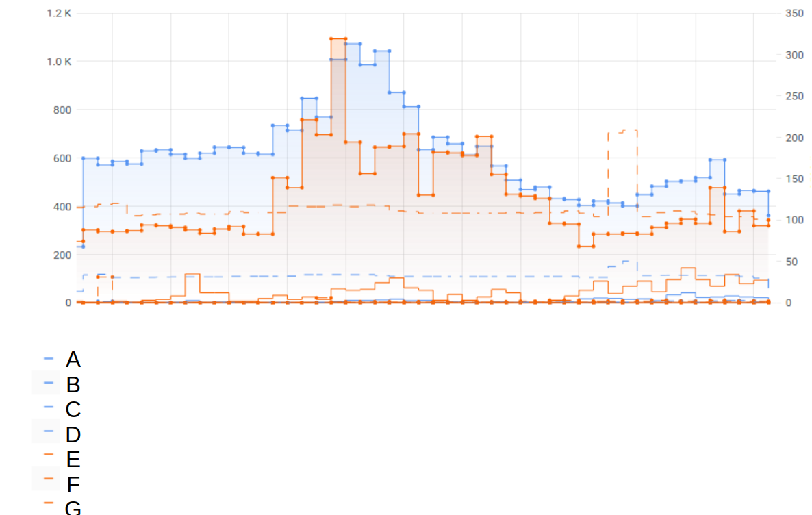

Hello,
Is it possible to display dotted and dashed lines on the legend? As you can see on the picture, they cannot be distinguished.
Thanks!
Hello,
It’s not possible currently, only using different colors can help you for that.
A feature request has been submitted: https://github.com/grafana/grafana/issues/13594 and you can show your support for the feature by adding a thumbs up!
