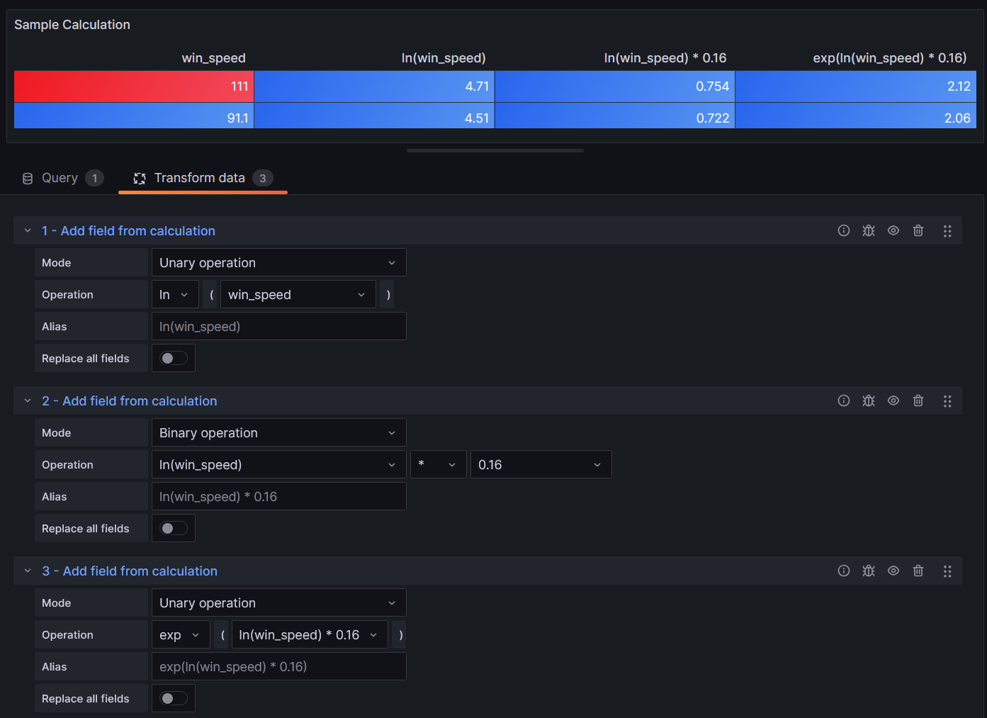

Did you try Add field from calculation transformation?
Example of wind_speed^0.16 calculation:
That last one (3) is the correct number (thanks) but I can only add a field but can not add * 0.16 to the end, also to grab the wind speed, i have to make a query but this shows up in the graph, is there a way to get rid of this?
Thanks everyone for the help, sorry for the slow reply
Try Organize fields by name transformation for hiding unnecessary fields:
