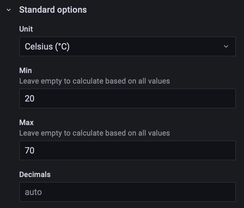

I have the same Problem, it’s very annoying, here are some screenshots:
I am using a lot of Histograms for different use cases, all with the same result (non-working axis limit settings).
