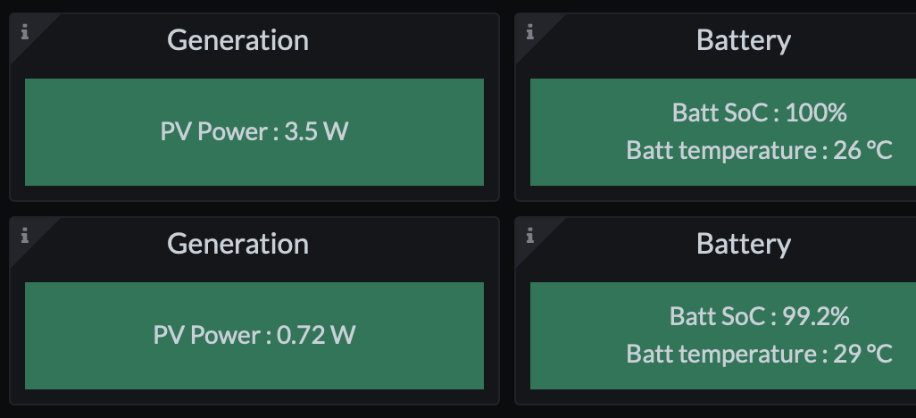

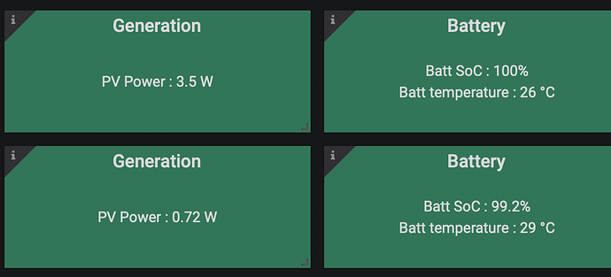

In terms of what’s stopping us from upgrading, it’s mostly plugin compatibility. For example in some of our orgs/dashboards, we use status panels quite heavily (Status Panel plugin for Grafana | Grafana Labs). Although that plugin did actually recently get an update that fixes compatibility with Grafana v7, it still looks quite different in v7 (see below).
So while at this point it’s mostly cosmetic differences that are holding us back from upgrading across the board, part of it is just trying to not rock the boat too much for our users.
