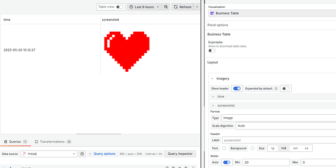

How about trying out the Business Table plugin from vol

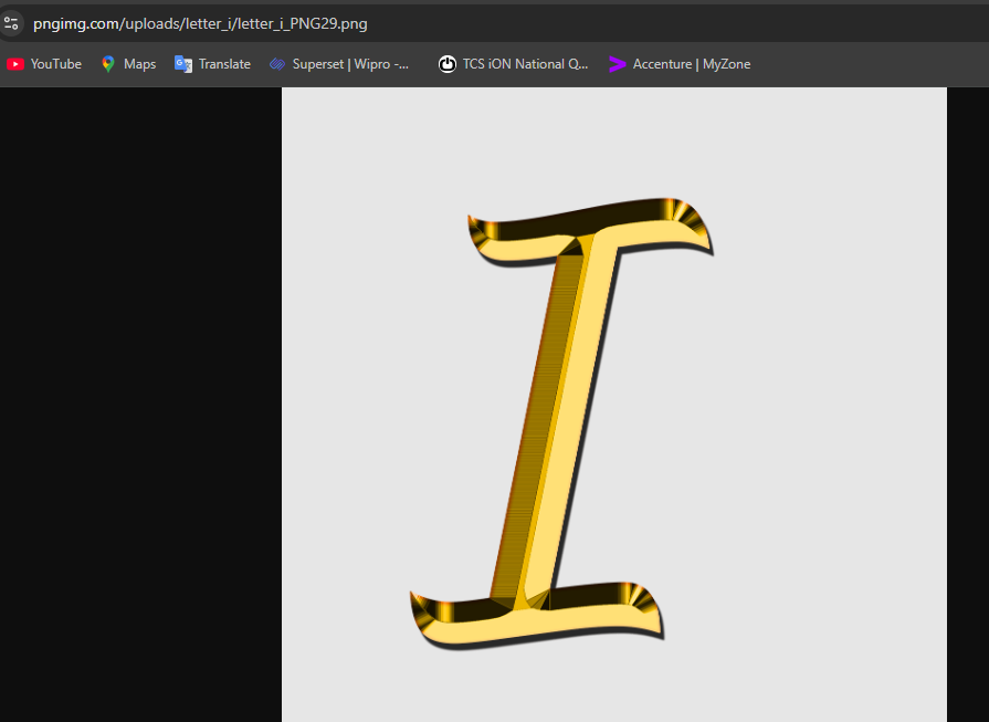

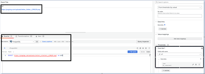

Please try this using this you can able to open the online image/webpage/etc…
