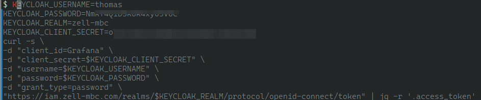

So I went ahead and deciphered what Keycloak is returing via calling it directly from the cli:
Followed by sticking the token into this service JSON Web Tokens - jwt.io

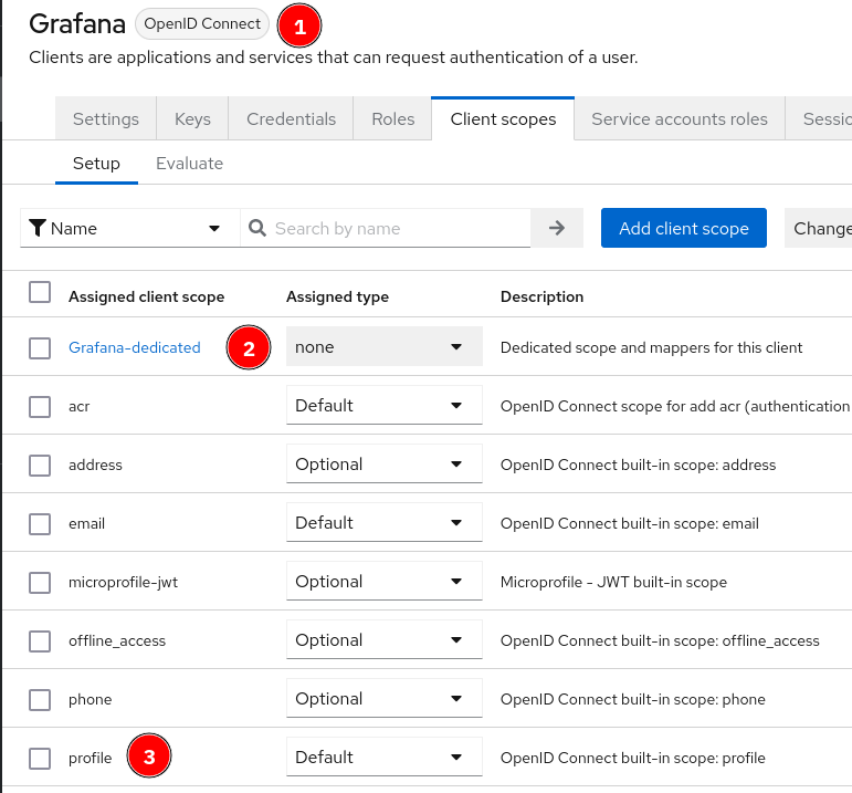

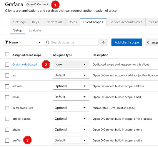

I meanwhile changed the email scope in Keycloak from optional to default, which makes the email address show up in the token payload.
I tried adding “email” explicitly to the scope, with and without “profile”, but no success.
GF_AUTH_GENERIC_OAUTH_SCOPES: “profile, email”
Other than that, the client is set up as OpenID connect (#1)
