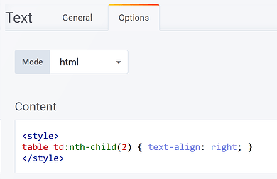

Hackish work around is to play with css selectors in additional text (html mode) panel.
For example: style all second columns of all tables:

@orena4 It’s in the text panel, not in table.
I tried the suggested solution, it didn’t work… thanks
It doesn’t work, because there was a breaking change and html panel is sanitized by default from Grafana 6+:
The text panel does no longer by default allow unsantizied HTML. #4117. This means that if you have text panels with scripts tags they will no longer work as before. To enable unsafe javascript execution in text panels enable the settings disable_sanitize_html under the section [panels] in your Grafana ini file, or set env variable GF_PANELS_DISABLE_SANITIZE_HTML=true.

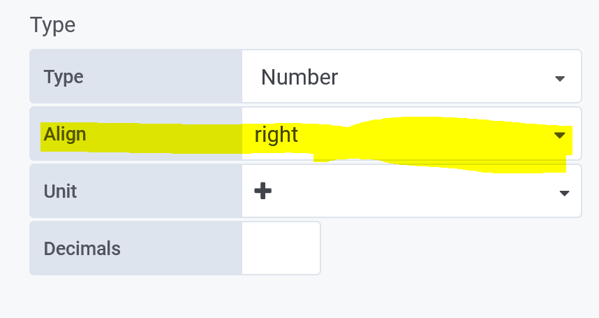

Yes, upgrade to the recent Grafana version, where column alignment is implemented:
