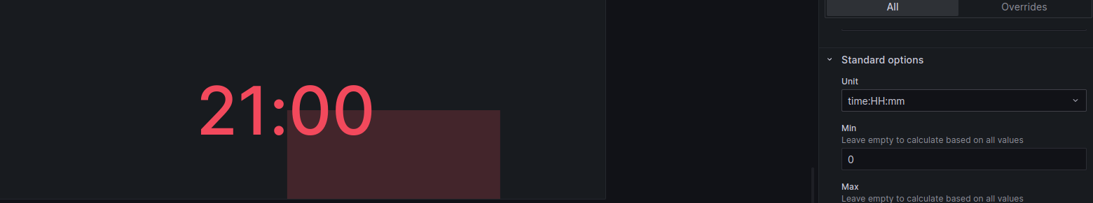

Hi, im need date as time:HH:mm, but this dont work, the date that was supposed to be 04:53 is turning 21:12

This dont work, is showing:
The correct value is this:
But, if i remove the ss, is turning

Now is 05:07, because the info was changed. Show with time or duration HH:mm:ss is not a problem. The problem is when i change only to HH:mm.

ok, in short, I get information from zabbix and it comes back to me in seconds, I need to show it in grafana like: 00:00h. In grafana I have the format 00:00:00h, (HH:mm:ss) this transforms my information from seconds to hour perfectly, but if I use HH:mm, to transform it to 00:00h, the transformed information get wrong , an example: the correctly time it should showed 05:07h from 1842 seconds, is showing 21:00h
