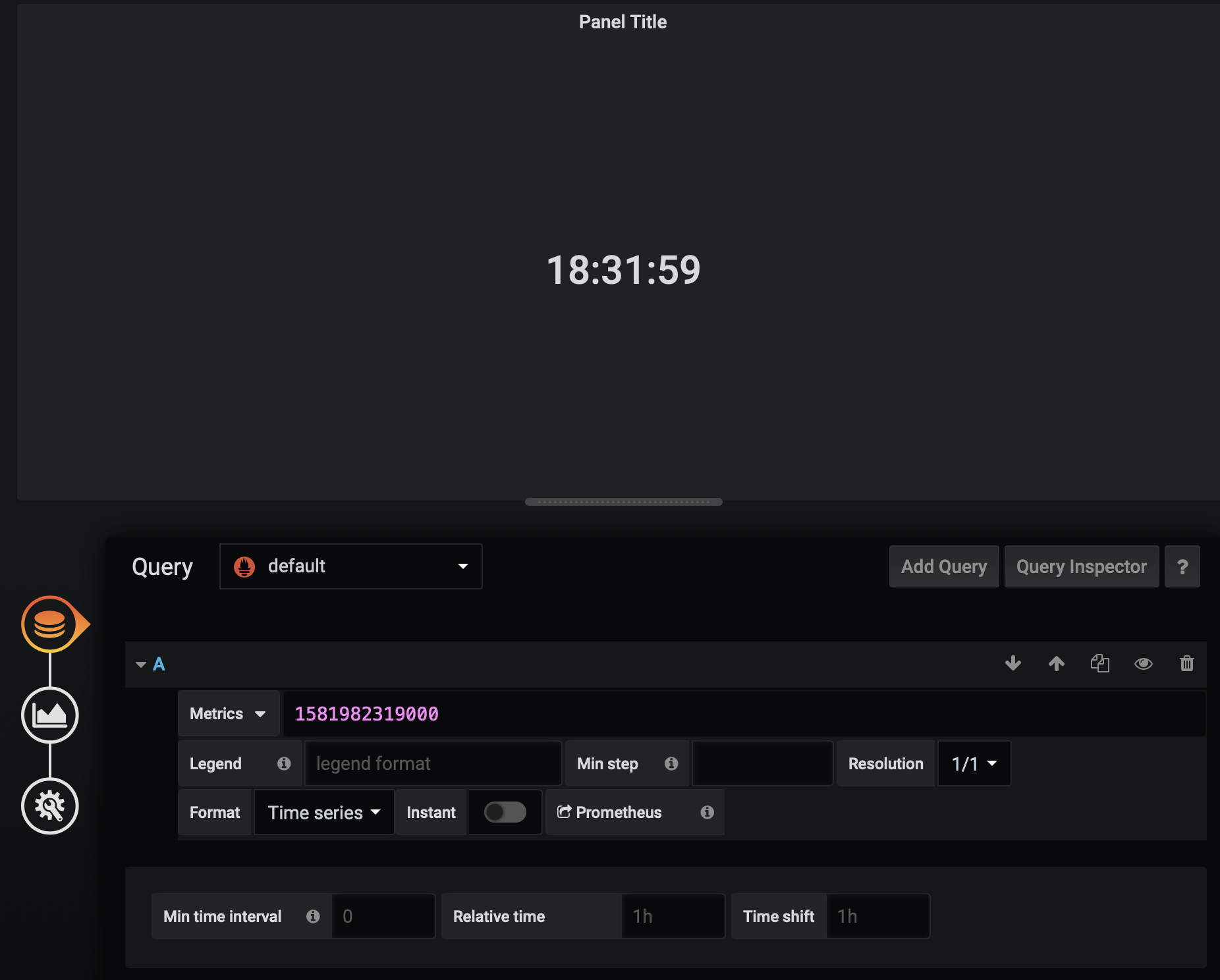

Not working for me. v6.6.1 (21bf8b71bc)
When I put a timestamp in like 1581982319 it gives “1970-01-19 02:26:22” as those above noted. However multiplying times 1000 corrects the time, but the date disappears! How to I get it to show the date AND time?
Playing around a bit more, I see it DOES display the date if the timestamp is far enough away from the present. Very strange behavior.
Did you ever figure this out @wkoontz? I see the same thing, the date disappears. I am running 6.3.6.
