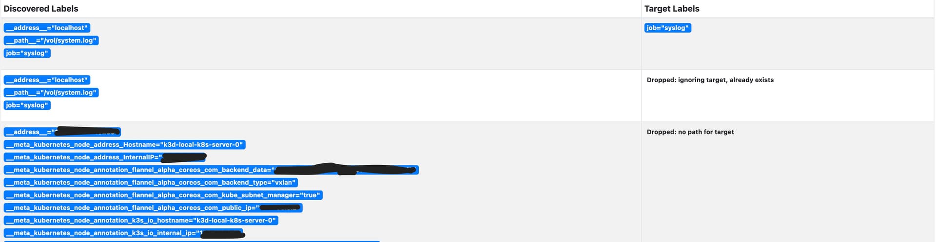

I did a little more digging and looking at the service discovery you can see that the promtail job exists, as do the kubernetes_sd_config labels. However, for some reason the $1 is being evaluated to null. If I change replacement: $1 to replacement: foo-$1, I see the syslog job with the node_name: foo- label. Any idea whats going on?

With the same config, I cant seem to find the kubernetes labels in Discovered labels section
