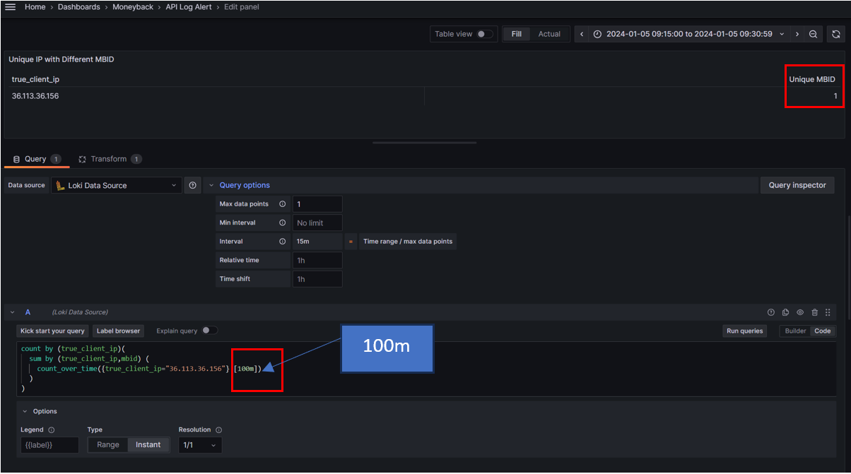

I applied the setting same as you provided, but I got below 2 different results with different interval setting. I checked the official document but still cannot find the problem.
I set 10m as interval then I got 3, and do you know why the “Alert” tab page is gone?
I set 100m as interval then I got 1
here is the related log record, retrieved by executing the same query in “Explore” page. the log are created in same minute (time is highlighted below)
Could you please advice? Many Thanks
  1. Because you are setting the interval implicitly already via setting the number of data point to 1, you have to use $__auto in your query.
  2. It’s better to use time series for alerting. We don’t generate alert from Grafana, we use Loki Ruler, so I am probably not going to be able to comment on this too much.

I use $__interval instead because $__auto is not recognized by Grafana Loki, but the result is still not correct, below is the setting
Here is the related Log record, mbid are blank, then I expect they will grouped together and counted as 1
and also I want to set an alert, so there is any LogQl and alert can achieve it in Grafana Loki.
