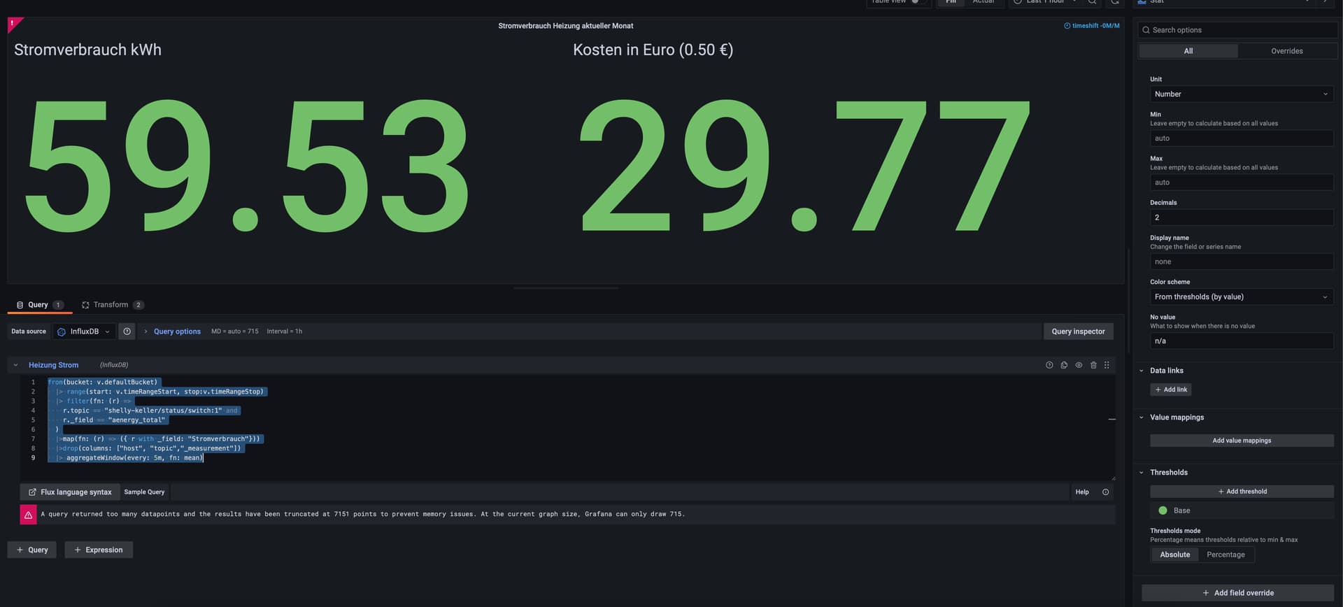

    Displaying an energy consumption and coast panel for the current month using stat panel type.
  • What happened?
    Getting Errormessage “A query returned too many datapoints and the results have been truncated at 7151 points to prevent memory issues. At the current graph size, Grafana can only draw 715.” on the panel and consumption seems not to be correct. I guess this is because of missing datapoints which cannot be used. Data is coming into influxdb via telegraf, every 5 minutes i get the current consumption as an float value.
    Stat panel should calculate all data without errormessage shown.

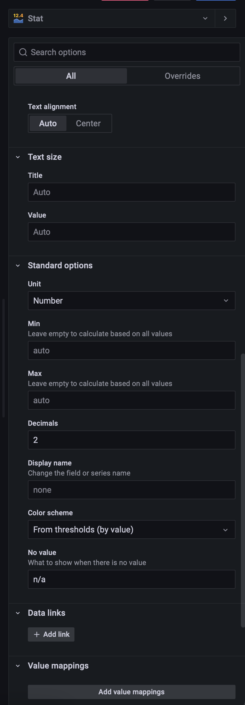

  • Can you copy/paste the configuration(s) that you are having problems with?
    Attached you can see the configuration of the Stat panel.
Im using FLUX-Query:
from(bucket: v.defaultBucket)
  |> range(start: v.timeRangeStart, stop:v.timeRangeStop)
  |> filter(fn: (r) =>
    r.topic == "shelly-keller/status/switch:1" and
    r._field == "aenergy_total"
  |>map(fn: (r) => ({ r with _field: "Stromverbrauch"}))
  |>drop(columns: ["host", "topic","_measurement"])
  |> aggregateWindow(every: 5m, fn: mean)
    Errormessage on stat Panel “A query returned too many datapoints and the results have been truncated at 7151 points to prevent memory issues. At the current graph size, Grafana can only draw 715.”

Hi @marcowa,
Have you tried adjusting Max data points under Query options? From your last picture I can see that Max data points is set to auto which is 715. Maybe increasing Max data points would solve the issue.
Best regards,
ldrascic
make sure that you’re not using a small aggreation window e.g (10 sec)
