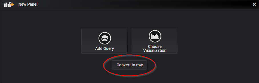

I can’t find a way to create rows inside a Dashbords using Grafana 5.0-beta 3 and 4.
Are they deprecated ?
I used to have repeating rows depending on templates variables. How am I supposed to do the same ?
Thanks.
finaly found it ! it’s a special “panel”… weird choice, but working…
Glad you found it. We kind of see rows as an advanced feature and starting from 5.0 you actually don’t need to create a row for adding panels and that’s why we decided to put in the add panel dialog.

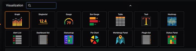

Hi Team,
I am not able to create Row on Grafana dashboard .i am using the version grafaana v6.2.1.
Please help me on this.
I guess it has been moved to the “Add panel”…
