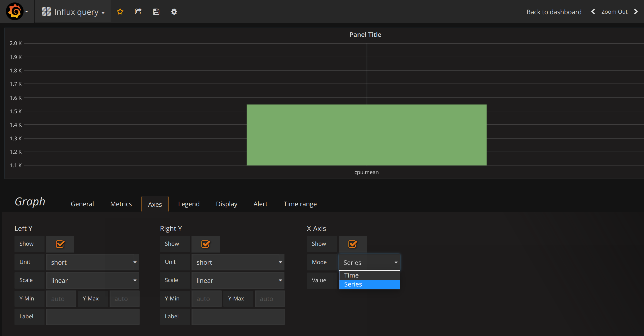

Do you mean the X-Axis mode option where you can choose between Time (the default) and Series:
Close, but that lumps all of my points into one bar, whereas I still want to plot each data point separately.
