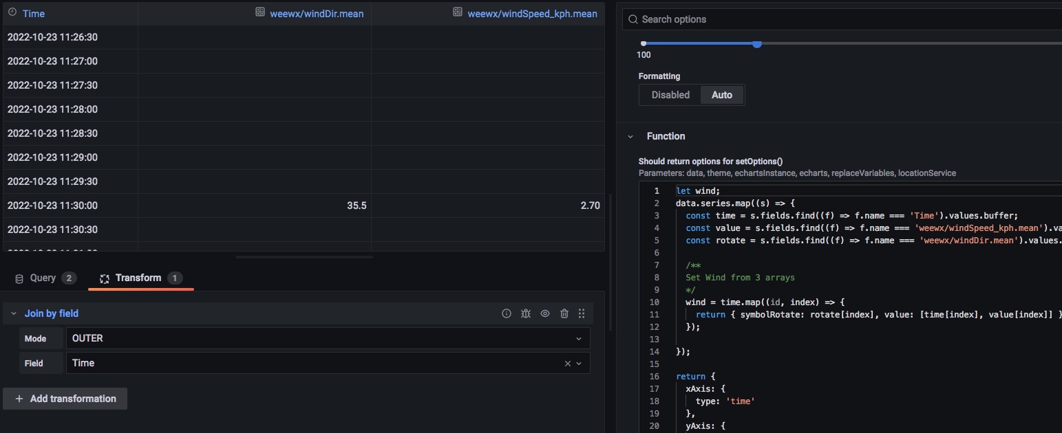

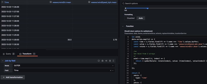

@Alvaro_Villa If you have multiple series, you can:
  1. Use the Outer join transformation using the Time Field name to merge them into one;
  2. Rewrite your queries to a single series with both fields;
  3. Rewrite the script to look for fields in all queries and then combine them.
Option 1 is the easiest:

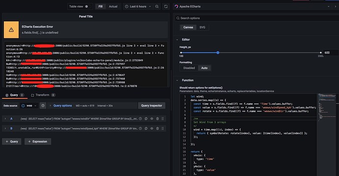

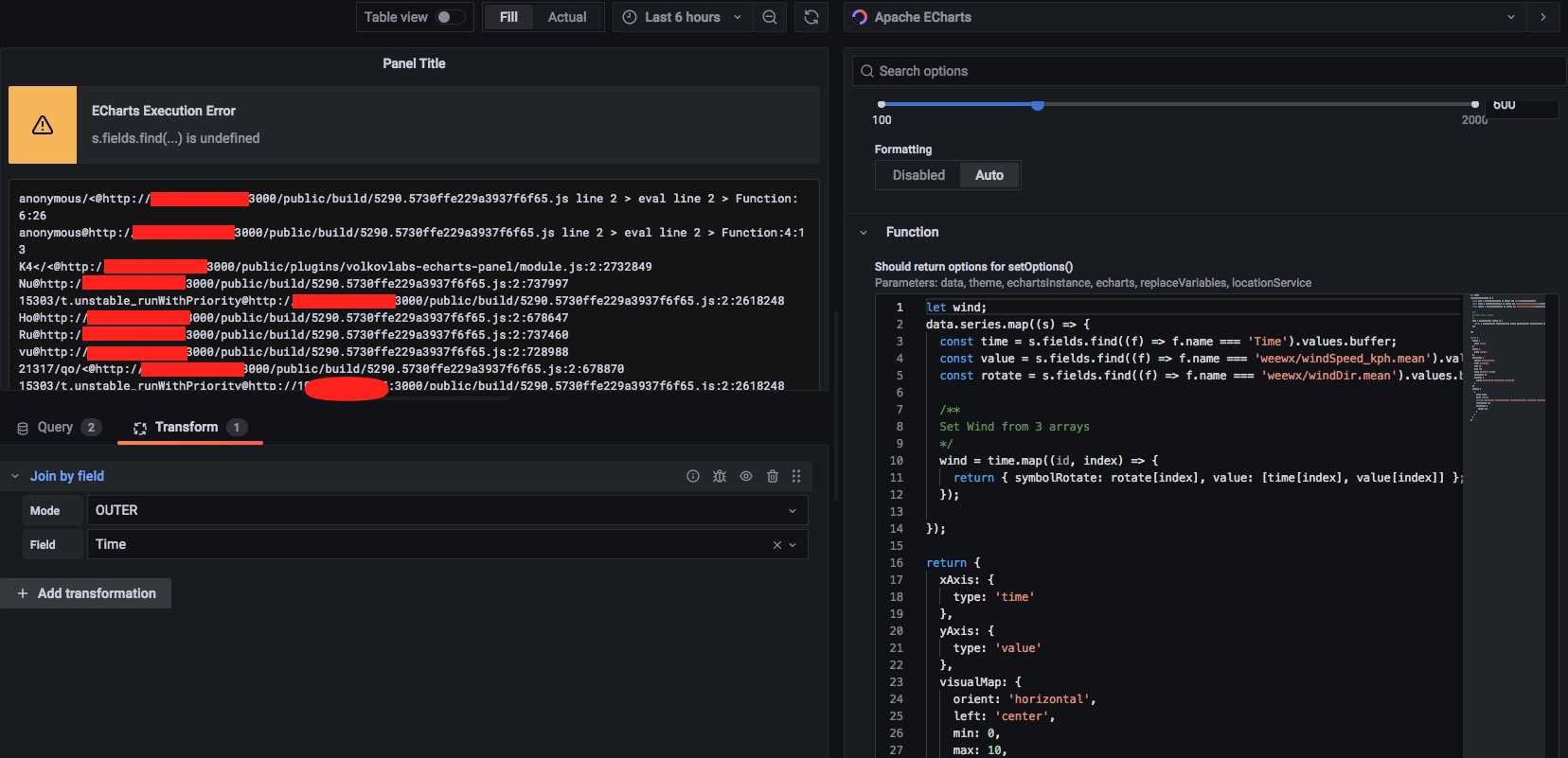

Doesn’t works :frowning:
@Alvaro_Villa What is your Grafana version? I am using 9.1.6.
I’m using the 9.2.1 version

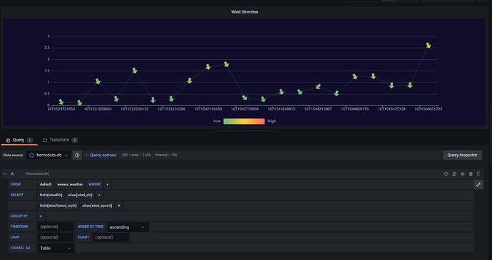

here is my current setup for those looking for help:
Couple pointers:
  • Format set to Table
  • Under transform perform a join like @ mikhailvolkov says
  • Filter out nulls (see second screenshot)

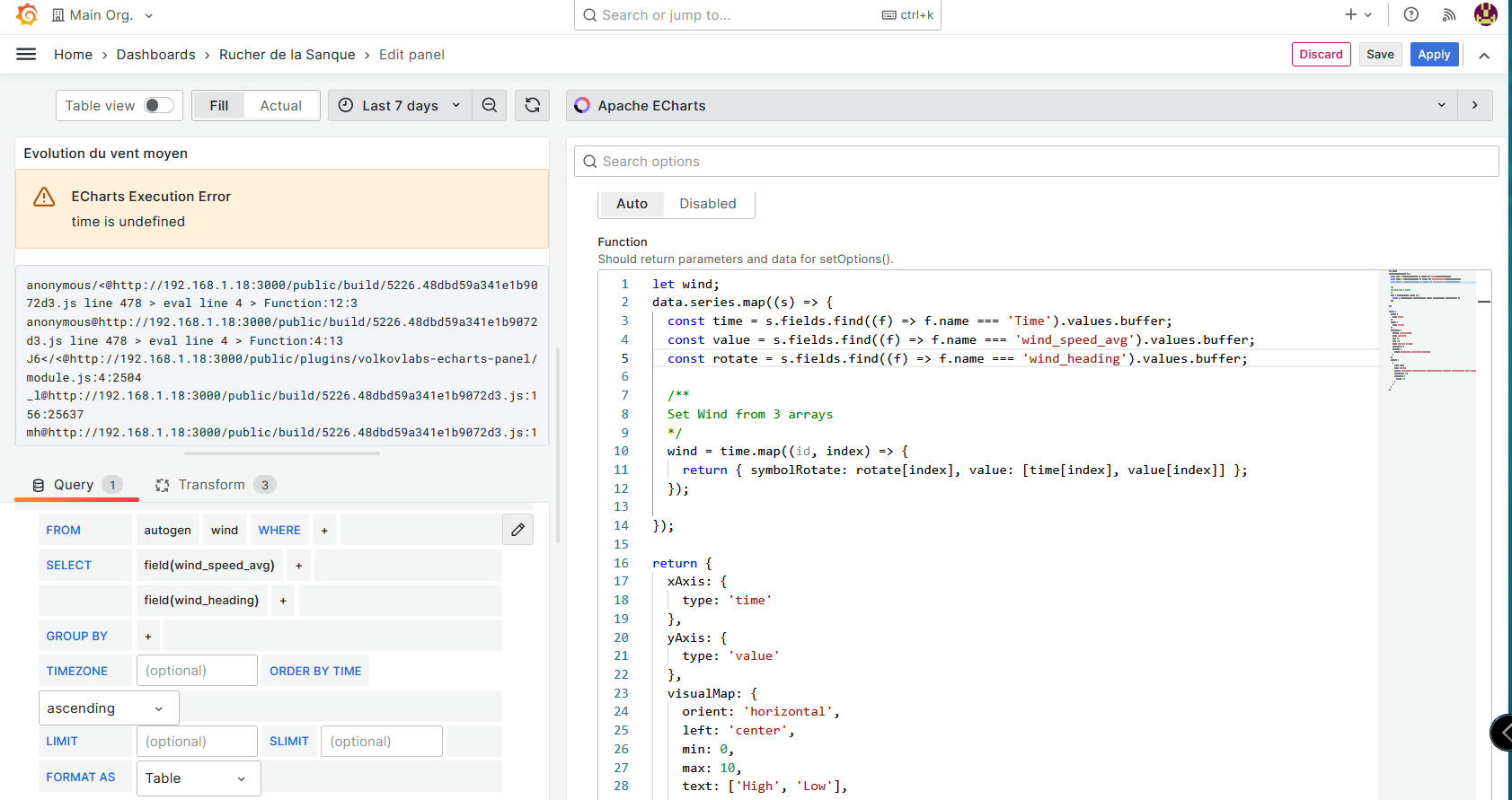

Hello,
I followed all the directions to create a beautiful diagram as above. Everything was working fine until I updated grafana to V10.0.1 and echarts plugin version 4.5.0. Do you have an idea to remove the error “time is undefined” Thanks

@Ratamuse Grafana 10 introduced breaking changes to get data from a data source using values.
Just remove the .buffer and you will be fine.
Grafana 10 is fully supported, I will update README to make it clear.
