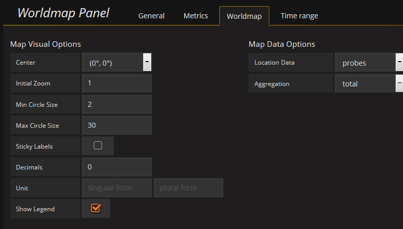

Here is the Grafana setup:
I get no error but there is no circles on the map, what am I doing wrong? What data should I provide to grafana from prometheus if it is the reason of the problem I’m having? Adding Legend format “{{geohash}}” doesn’t help either.
