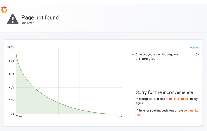

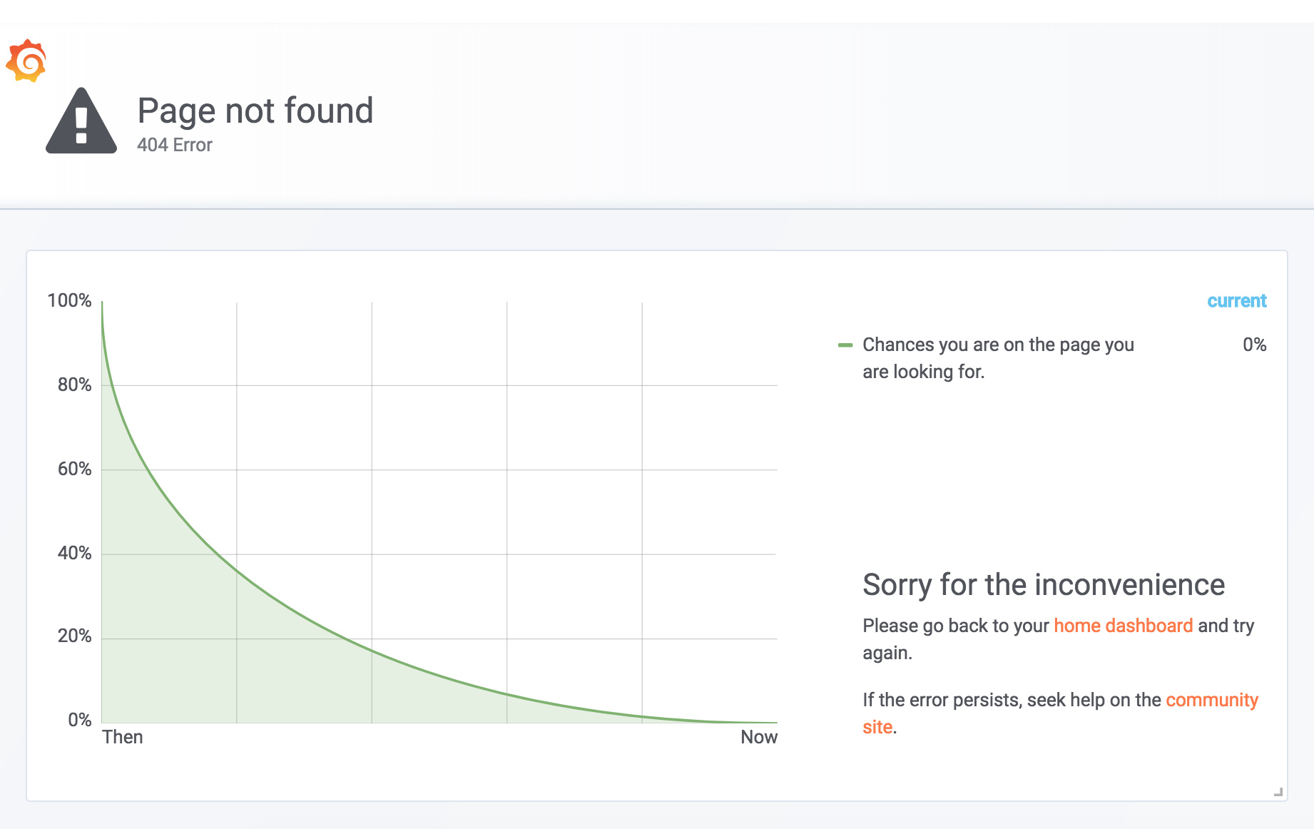

I’m trying to use NodeJS to implement an auth proxy that passes authorized requests through to Grafana in a Docker container. It seems to work with one exception. When I attempt to load a dashboard the response from Grafana is strange. I get a 200 status code but when I push the response back up to the client that it renders a Grafana branded 404 page.
The goal is to embed dashboards (in kiosk mode) into our web app and have the nodeJS proxy app bang our website to confirm that the user is logged in by detecting a 302 when loading the login page. I pulled that part out of the code below to simplify things.
The request is sourced from an iframe with a JWT appended to the src URL that includes the data needed for the proxy to assemble the dashboard URL that it uses in the request to Grafana.

NodeJS output:
Proxy listening on port 80!
Got dashboard request for /d/?access_token=eyJ0eXAiOiJKV1QiLCJhbGciOiJIUzI1NiJ9.eyJpYXQiOjE1MzE4Nzg0NjMsIm5iZiI6MTUzMTg3ODQ2MywiZXhwIjoxNTMxOTY0ODYzLCJzaXRlX25hbWUiOiJndW5uZXJhdXRvbW90aXZlIiwidXNlcmlkIjoyMzUsIm9yZ2lkIjoxLCJkYXNoYm9hcmRfbmFtZSI6ImRlLWZhY3RvcnktdmlldyIsImRhc2hib2FyZCI6IjNoMzVxNlNteiIsImRvenVraXNlc3Npb24iOiIzZWFmZmU5NmYxOGUyM2VhZDM4ZmMxNzNkYTY2ZDFkNCJ9.zPX8GtsGcLbgA90uOh384FXXvY9ch4g4zTaEr168erI
decodedJwt { iat: 1531878463,
nbf: 1531878463,
exp: 1531964863,
site_name: 'gunnerautomotive',
userid: 235,
orgid: 1,
dashboard_name: 'de-factory-view',
dashboard: '3h35q6Smz'}
Retrieving grafana asset at /d/3h35q6Smz/de-factory-view?orgId=1&kiosk
Setting Options:{"host":"172.17.0.2","path":"/d/3h35q6Smz/de-factory-view?orgId=1&kiosk","port":3000,"rejectUnauthorized":false,"requestCert":false,"headers":{"X-WEBAUTH-USER":"gunnerautomotive","Host":"grafana.<OBFUSCATED>.com"},"setHost":false}
Grafana request headers: {"x-webauth-user":"gunnerautomotive","host":"grafana.<OBFUSCATED>.com"}
Status code: 200
Grafana response headers: {"content-type":"text/html; charset=UTF-8","set-cookie":["grafana_sess=049e5895b7c9d230; Path=/; HttpOnly"],"date":"Wed, 18 Jul 2018 13:38:40 GMT","connection":"close","transfer-encoding":"chunked"}
Proxied response headers: {"x-powered-by":"Express","content-type":"text/html; charset=UTF-8","set-cookie":["grafana_sess=049e5895b7c9d230; Path=/; HttpOnly"],"date":"Wed, 18 Jul 2018 13:38:40 GMT","connection":"close","transfer-encoding":"chunked","pragma":"no-cache"}
Got data for dashboard
Finished grafana dashboard response
Any feed back is greatly appreciated!
