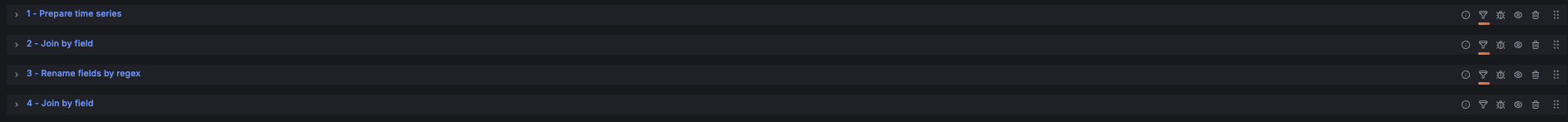

I have a general question about a use-case we have. We have a table panel that we would like to create in grafana, where we have columns (from pg data source) benchmark_name, metric_value, profile_file, revision and a timestamp in the form you can see in the screenshot.
The profile_files are different for each benchmark_name, so that’s why you can see in the screenshot that we created a time series to load it as a label to be used by data links later on in the final result.
Then, we’ve done some join operations for some other queries to also get additional information such as revision.The percentages you can see in the desired result is the difference between the original-… and project-… benchmarks. We can gather these percentages directly with a SQL statement (instead of metric_values). However, if that’s the case then we cannot use a “Prepare Time Series” transformation to append labels such as profile_file’s to the final result (as metric then becomes a string), for data links. So the question is:

I agree that we should have grafana do the visualization only. Hence, I created a corresponding function that can calculate the difference between the metric values of different revisions of the same benchmarks, and append a new field to the returned query results wherever needed e.g. metric_value_display: ‘45.0 (+3.5%)‘, metric_value: 45.0.
However, the transformations need to be kept as far as I understood. Because I need to append profile_file into the labels of the columns, to be able to create a data link. And as far as I can see, there is no way to have labels without using time series transformation on the data…
