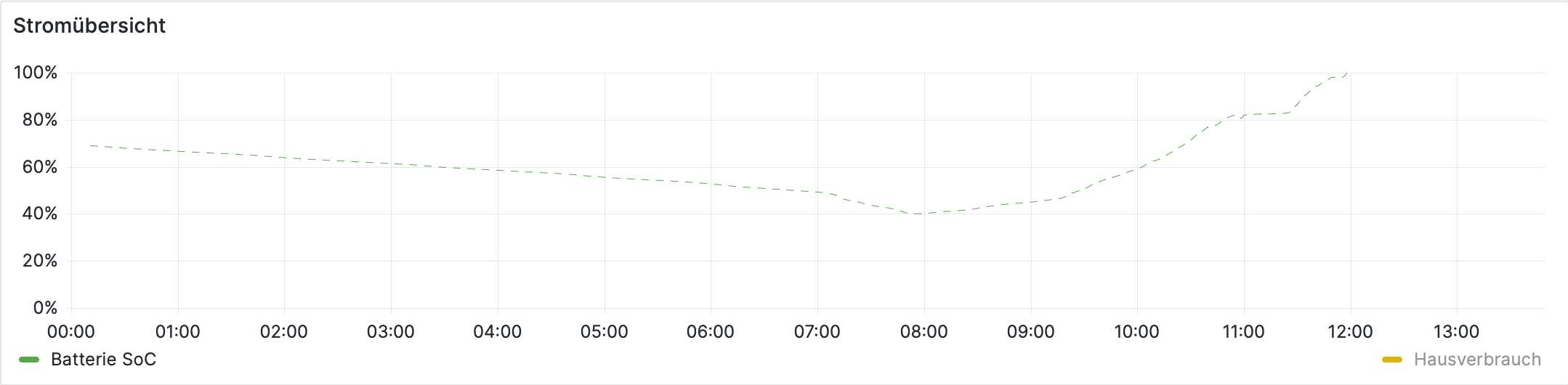

Here is my example 2 (State of Charge):
It’s the same with the state of charge. When i reach 100%, there are no more values written into the influxdb. So the line stops at 12:00.
