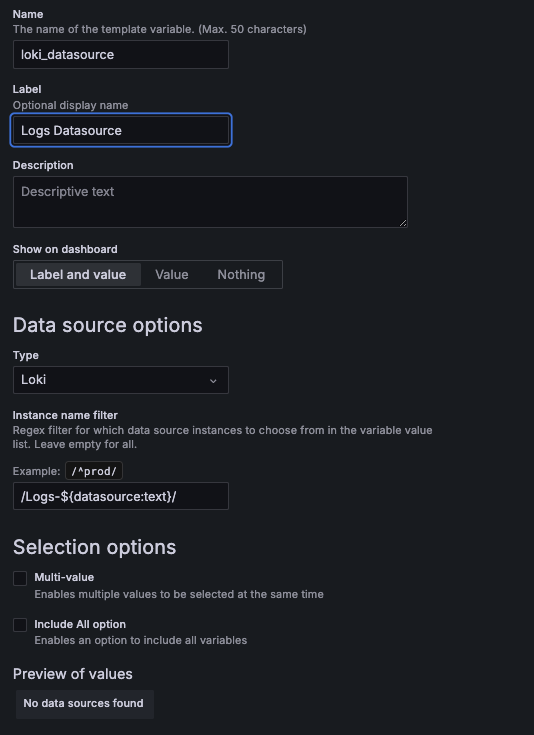

So I created a datasource variable with Type Prometheus and tried to use it in the Instance name filter for other datasources. But it doesn’t work. It works fine in case I use Custom variable, but not one of type Datasource.

Try advance formatting in Instance name filter, e.g.:
/traces-${datasource:text}/
Because /traces-$datasource/ may have datasource UID, not name there.
Unfortunately, this one doesn’t work as well

Here is what I tried to do for logs
and here is a list of available Loki datasources:
Debug how is ${datasource:text} interpolated in your case,pls. Check errors in browser console,…
Yeah, it was my mistake (datasources with and without MIMIR at the end)
@jangaraj you solutions works perfectly. Thanks a lot!
