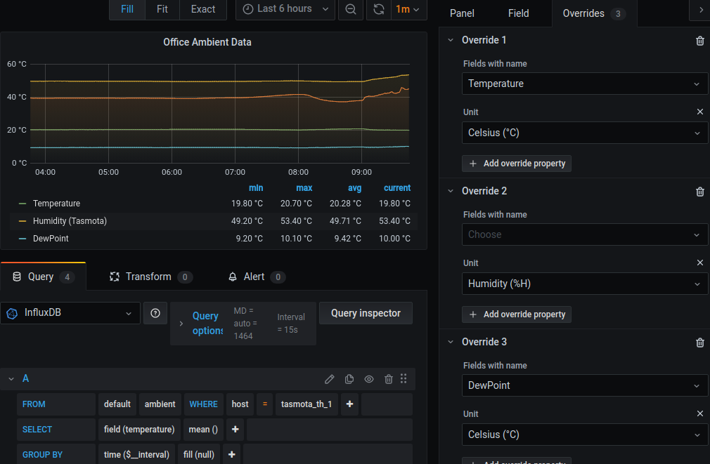

I am using grafana to visualise data stored in influxdb.
In my panels I have multiple channels e.g. temperature, humidity, pressure and so on.
Now I am using overrides in grafana to set the correct unit for each of the visualised channels.
Unfortunately those overrides are not working well. Only the very last override “unit” is used for all channels alltogether.
Am I doing something wrong here or is that just a silly bug?
I think the screenshot tells more than words :slight_smile:
Please help/advise.
Thanks!
Best regards,
Bernhard

I’m having the same issues. This should be logged as a bug.

I am wondering how this is supposed to work. There are only 2 y axis, so what’s the purpose of changing the unit per series?
Maybe it makes just sense for tables?
@fliegenklatsch
It makes sense for your legend, min/max/avg information and tooltips when you hover over the graph.
