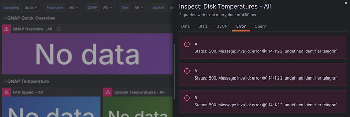

Hi all,
I’ve downloaded a dashboard from Grafana site => QNAP Dashboard - Telegraf SNMP - InfluxDB | Grafana Labs
With Data explorer I can see measurements:
but not inside the dashboard:

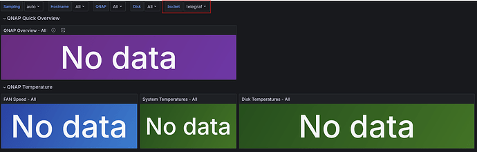

as you can see I’ve added variable “bucket” and selected “telegraf” because is the right bucket and inside configuration of the dashboard I modified “bucket: v.defaultBucket” in “bucket: telegraf”.
What other check should I try?
Thanks,
G.

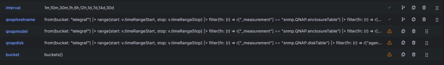

Did you modify that in all panels and all variables?
Hi @ebabeshko,
to be honest inside variables yes:
while inside the json I tried to change “v.DefaultBucket” to “telegraf” but dashboard started flashing :sweat_smile:
so I recover it back with “v.DefaultBucket” in json and set bucket from the variable in the dashboard page on top like posted in my first comment

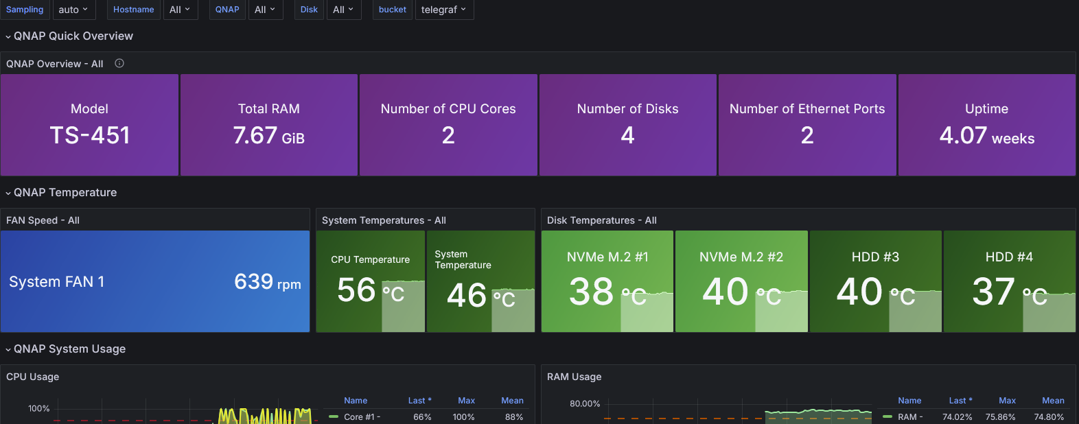

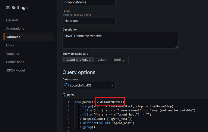

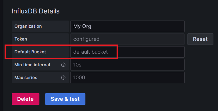

what does the query inside the dashboard look like?
Bucket name (telegraf) should be enclosed in double quotes ("telegraf")
v.defaultBucket is being taken from Connection settings, not from variable:
Is it set to telegraf in your case?
If you want to use dashboard variable to specify the bucket to query data from, you should change v.defaultBucket to "${bucket}" or ${bucket:doublequote} in panel queries

set bucket name in variables with double quotes :wink:
Inside Connection setting is set another bucket, probably because was the first created:
immagine
the problem is that if I change it with v.defaultBucket both dashbaords (fritzbox and qnap) crash even if I set the bucket inside variables.
where should I change v.defaultBucket to "${bucket}?

If you just change it to telegraf in Connection settings and leave v.defaultBucket in panel queries, does it work?

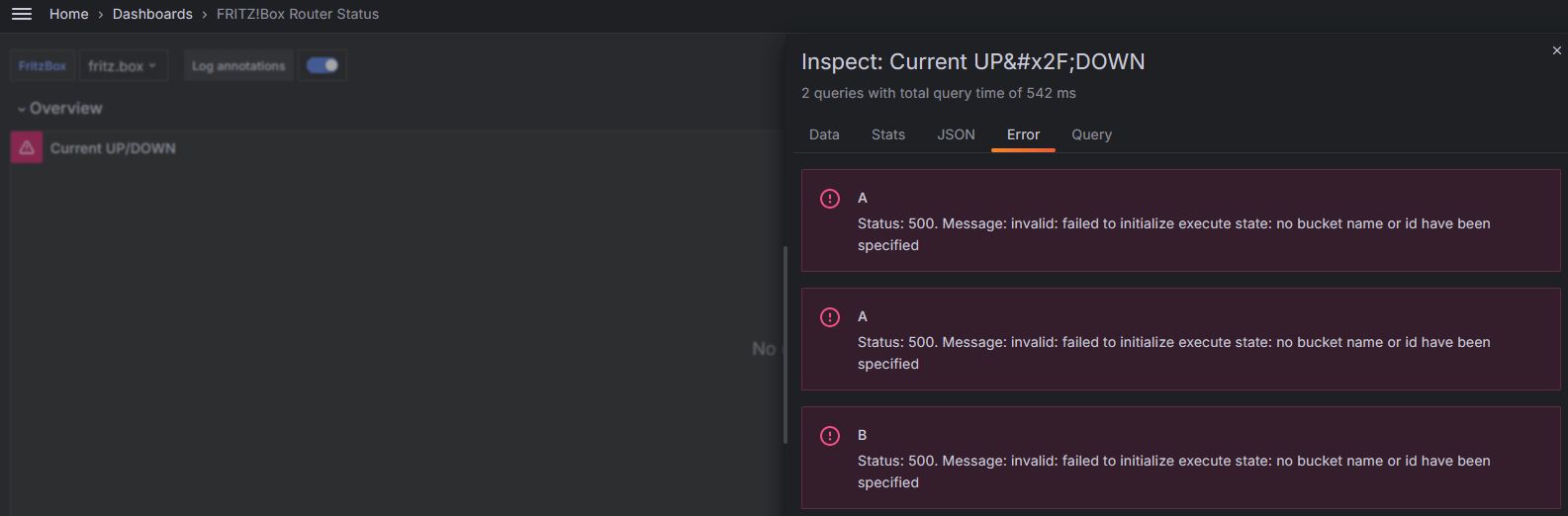

Yes if I set telegraf as default bucket in influxDB connection settings and change “telegraf” in “v.defaultBucket” in variable queries it works:
but the other dashbaord stop to work:
Ok, so just change v.defaultBucket to "telegraf" (don’t forget double quotes) in all variables and panels of your QNAP dashboard. I don’t think you need to declare bucket variable at all for that dashboard in your case.
you mean inside variables and json or only inside variables tab?
Anyway the problem is that if I remove in influxDB connection the default bucket both dashboards don’t work even if I specified the bucket inside the variables:

ok solved changing every “v.defaultBucket” in the right bucket in both dashboards in variables and queries :slight_smile:
Thank you so much for the support!
G.
