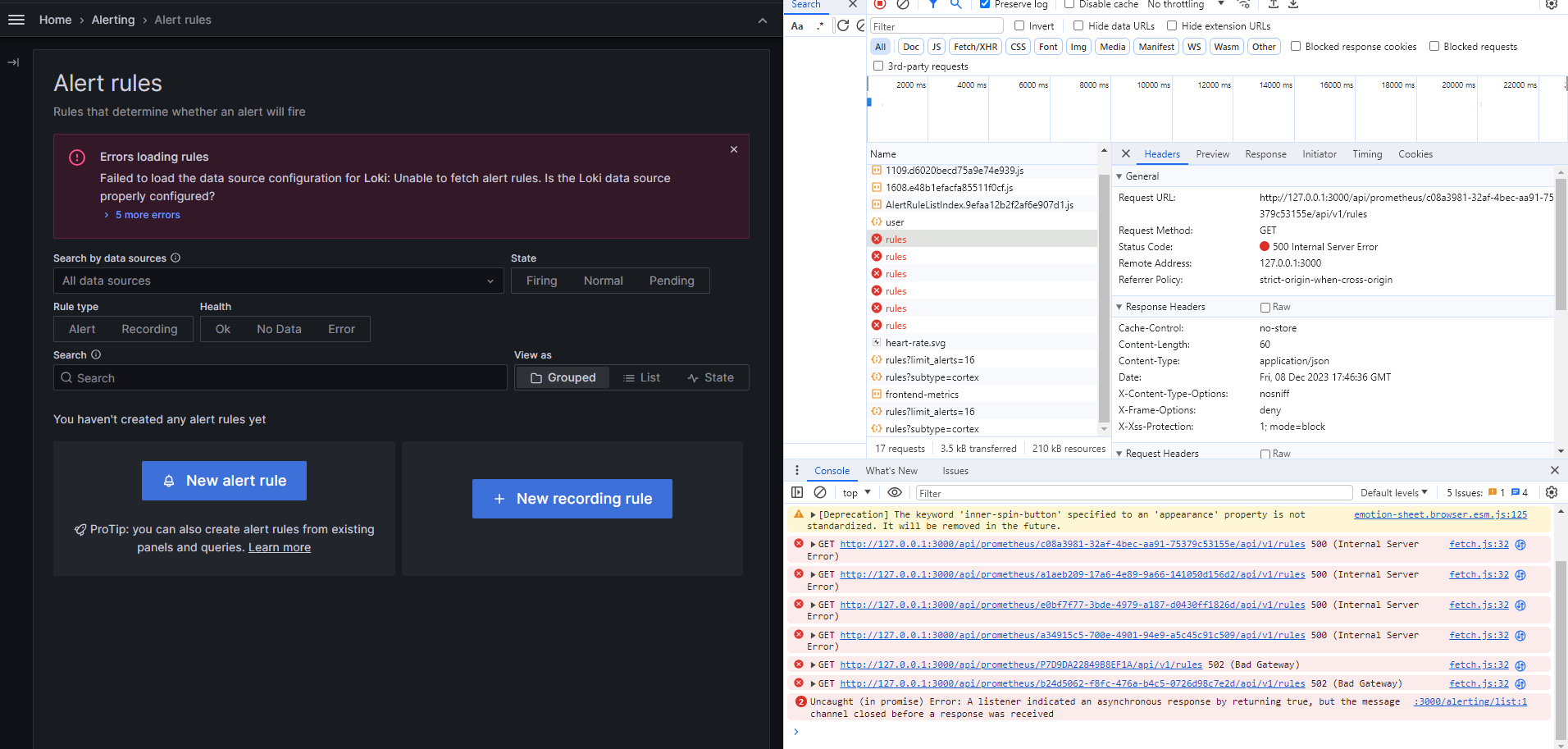

Hi All,
i need help in resolving “Failed to load the data source configuration for Loki: Unable to fetch alert rules. Is the Loki data source properly configured”.
i followed below previous post but it did not helped: grafana/grafana#49618
Thanks

i am not sure what do you mean since i am new to grafana, but after installing Grafana, Loki and Promtail then i simply added a Loki data source and connection was successful and i was able to see the logs. is this what you are suggesting. ty
What is the step to create the alert in the alert rule?
If there’s any screen shot, you can paste he, you can redacted the sensitive data for sure…

It depends what do you need:
1.) you need to remove error message
Just disable “Alerting” feature in your Loki datasource configuration
2.) you want to use Loki alerts (= alerts are stored in the Loki and not in the Grafana - I would say this is advance topic)
Investigate issue - there are topics about this type of issue on this forum
When I was first setting up Loki Ruler and managing Loki rules via Grafana UI, I had the problem that Loki query API did not share the same hostname as the ruler API.
This was what solved it for me Loki Alerting Issue · Issue #49618 · grafana/grafana · GitHub
Basically there is an Nginx reverse proxy that combines the Loki query and ruler API under the same hostname, which you then use as the datasource in Grafana.
