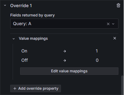

Unfortunately I can’t change it in Influx because the data’s variable: sometimes it’s a numeral, other times strings, so I’ve needed to write everything as the lowest common denominator: a string. (For the panels that require numeric input, the Convert field type → number works well).
Using an override doesn’t appear to make any difference:
This still doesn’t work. :frowning:
