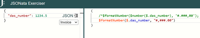

only probably way is to use jsonata as follows. I cant get it to implement that format
which uses xpath standard
https://www.w3.org/TR/xpath-functions-31/#func-format-number
Thanks for the tip. You’re right, I haven’t found a way to integrate the $formatNumber function with the JSONata path. ![]()
