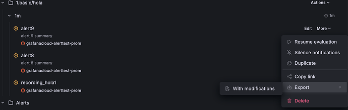

Hi @lopter,
As @jangaraj suggested, we recommend starting by building the alert rule in the Grafana UI.
The query and expression details are tightly coupled with the Grafana UI and API, so it’s the easiest way to get them right.
In the UI, you can also export your alert rule in TH format.
This workflow lets you modify the rule in the UI and observe how those changes are reflected in the TH configuration. It’s a great way to learn how the Grafana Alerting API works under the hood.

Hi again @lopter,
You didn’t sound negative. I agree the format isn’t obvious, and it’s not properly documented (which is why I recommended learning by using the UI).
You wrote:
means you are doing a range query (unless you have instant = true that is) and you therefore end up with multiple values and violate point ① documented at Queries and conditions:
DOC: The query returns a collection of time series, where each series must be reduced to a single numeric value for evaluating the alert condition.
That doc sentence could be clearer. The initial query does not need to return a reduced value. The important distinction is:
  • The initial query can return a time series (or multiple time series).
  • Normally, a reduce expression then reduces all data points in the time series to a single numeric value for the alert condition.
The initial query could also provide the reduced value — I guess this is where you’re running into an issue.
I’d still suggest using the UI to get it working first, and then exporting the Terraform (TH) code. I believe this workflow will make things easier.
