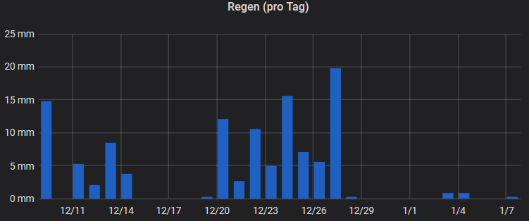

this gives me the bar chart I was looking for:
For my second goal I would like to add up the calculated values of the querry above to give me a line chart where I can see the cumulative sum of the selected period.
