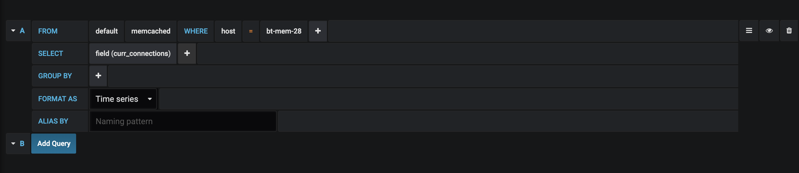

Please find my status panel . Would require your help. I think my mistake might be that we are not adding the value in the metric tab instead we are adding it in the options tab under display settings,maybe because we are getting it that way
That’s the query editor for the TestData DB datasource, your datasource query will look different. Looks like you are using influxdb.
Query A from the “metrics” tab is going to be automatically tied to Metrica: A in the “Options” tab, and from the above setting will be the last value.
I think your query is not returning valid data. You can check query results by using the query inspector option in the metrics tab. You may need a “group by” or additional fields to narrow it down to the metric you want.
Thanks . The issue is resolved. Based on the query inspector I realized the values we have set as threshold is wrong, when I readjusted the values it works like a charm.Also under options tab, we need to add alias for the metric else it wont work.
