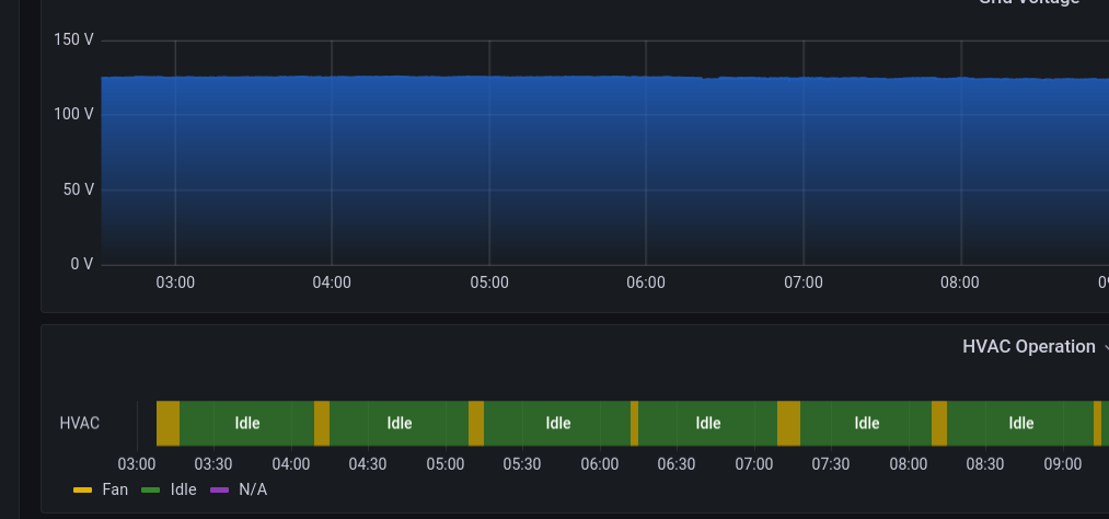

This is what I mean:
I want to remove the “HVAC” legend at the LEFT of the state timeline, so that the time scale of the state timeline will align with all other graphs in the dashboard, like the one above

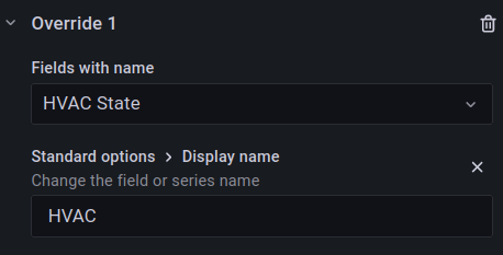

The old custom plugin I was using for the last few years (and that seems to have disappeared since I guess the functionality was added to Grafana core) had an option for this. I tried with a simple override like this one:
but it doesn’t accept a null value (it goes back to the metric name), and if I replace the display name with e.g. “-”, this doesn’t fix the time alignment with the other graphs, it’s like there is “space reserved for the metric name” to the left of the state timeline that remains regardless of the display name length.

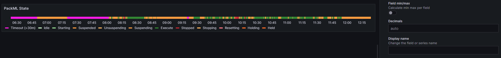

I’ve found a solution. It is possible to use the ‘delete’ (16#7F) character:
Copy it and past it in the “Display name” property.
16#7F
Put that to display name value in override property 16#7F
