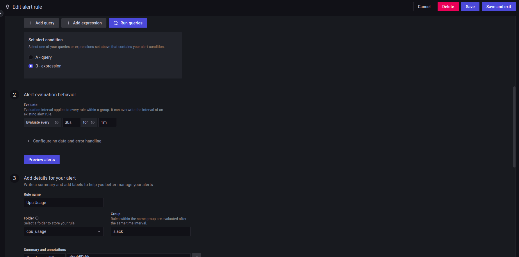

Looking at the log lines you provided. It seems that you are missing labels in there, Can you please screenshots (or maybe a screencast) as how you are configuring your alert?
Thanks for the help @usman.ahmad please find the alert configuration.
please check and solve my problem.
What happens when you click “Preview Alerts” button on step#2 ?
