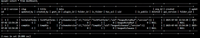

The only thing left in the dashboard table are the dashoard folders:
all the dashboards I had are gone.
(the table dashboard_provisioning, that contained all the provisioned dashboard info is empty, as expected)
