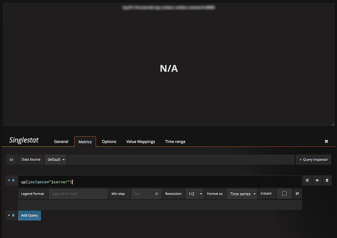

Probably important detail I forgot to mention: I’m using prometheus as datasource

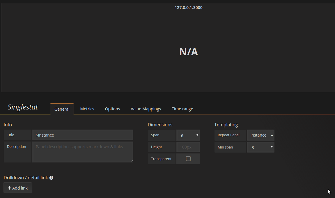

Here is the configuration I’m using:
Template:
Panel “General” tab:
Panel “Metrics” tab:
Result:
Hi,
I’ve verified that your above configuration works, at least on the latest version of Grafana.
Make sure to save your dashboard and then reload the browser to make sure that your settings have been updated in UI. I didn’t need to do this though, but I verified that it still works after I saved it, navigate to home and then back to dashboard.
Please see my configuration screenshots below using Prometheus as datasource:
Template variable setting:
(First, variable are not hidden so that I can select the values I’m interested in, see Selecting two values out of 3: below)
Singlestat panel settings:
Then I hide the variable according to Template variable setting screenshot above.
And final result:
I think my configuration are exactly like yours. What version of Grafana are you using?
