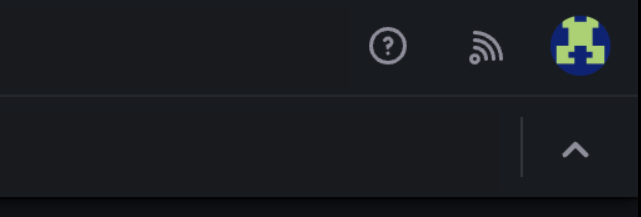

Hi.
Is it possible to remove the “help” and “latest news” icon that are placed in the top right of the screen near the account avatar?
figure1
