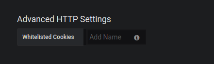

Currently we dont forward headers/cookies to downstream systems. But we added support for this in Grafana 5.0 (currently in alpha, available as night builds).
In 5.0 you can whitelist headers that you want to keep for downstream systems.
