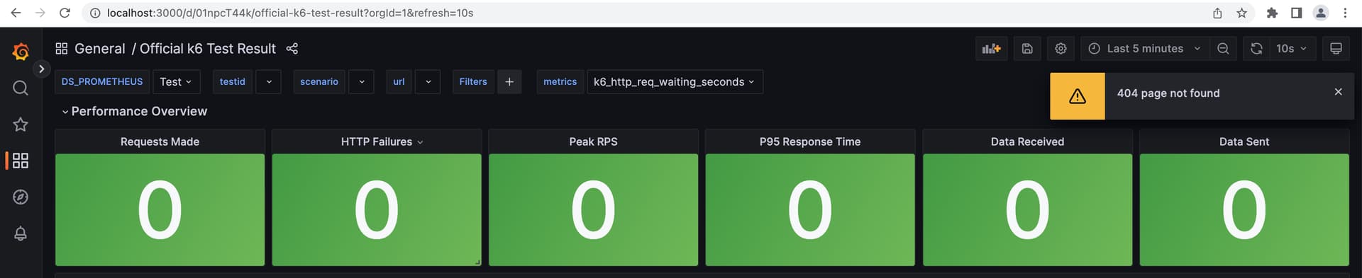

I’m not sure why it does not work for you, unless the contents of grafana directory are not the same I have (running on Mac OS).

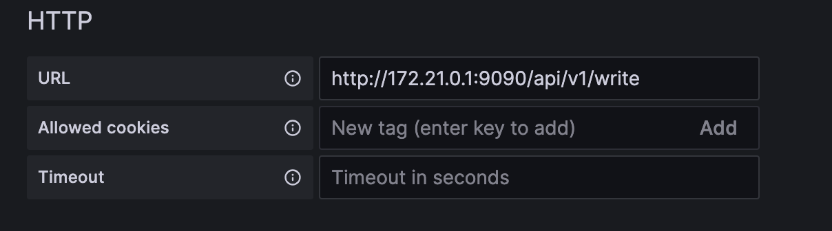

I run the example from https://github.com/grafana/xk6-output-prometheus-remote/blob/main/docker-compose.yml. Using that repo, it loads the dashboard from https://github.com/grafana/xk6-output-prometheus-remote/tree/main/grafana/dashboards, and seems to work well for me. I do not have to change the Prometheus URL, http://localhost:9090/api/v1/write works well.
This is probably what you need to investigate further. Is your local environment working with the URL we expect from inside the container, http://prometheus:9090 (it should probably translate to 172.21.0.1:9090 in your case)?
You can probably check in the grafana container has issues connecting to prometheus:
$ docker exec -it <grafana-container> /bin/bash
2107a0272568:/usr/share/grafana$ wget http://prometheus:9090
And also double-check the Grafana docker logs, to see if anything is suspicious when you are running this dashboard.

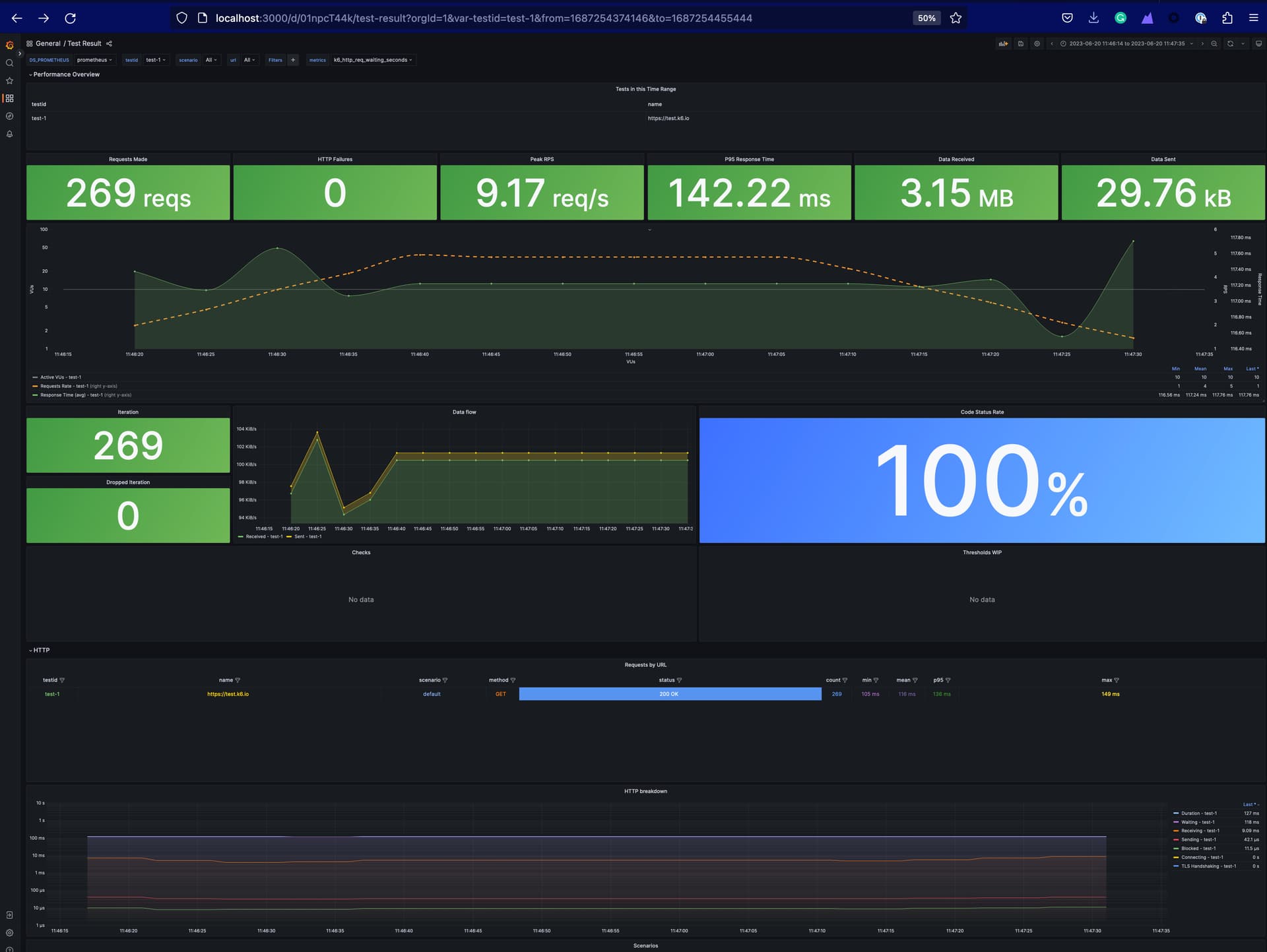

In my case, I followed the instructions at Prometheus remote write and used your k6 test script. The only thing I changed was increasing VUs and duration so that I could see a bit more results. With the default script, you will run an interaction without much data to be seen. Though you should still see the one request:

I ran the test above with K6_PROMETHEUS_RW_TREND_AS_NATIVE_HISTOGRAM=true k6 run -o experimental-prometheus-rw --tag testid=test-1 ./samples/test.js and the results show as well, with no need to reconfigure anything as you had to:
