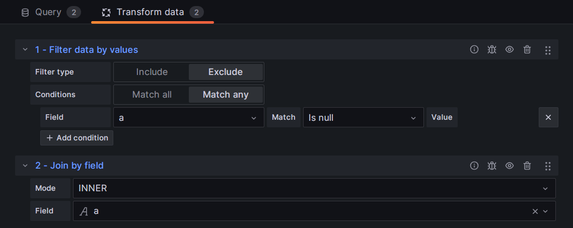

Do you want to get empty result when column a has null values?
I think you can achieve that by filtering out null values using Filter data by values transformation before Join by field:
No, let me try to clarify:
Case 1:
Both data frames is not empty ($var = 1) → apply inner join
Case 2:
One data frame is empty and the other is not ($var = 0) → show only a non-empty result and do not apply inner join
I would try to return dummy data instead of empty response by datasource means to make join work, or may be consider another join types…
Thank you! Using dummy data really helped fix the problem, but I still regard it as a bug because inner join should works differently.
