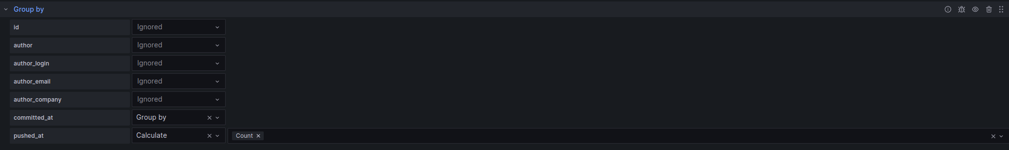

The problem is: I have a panel in a dashboard to show a bar chart with total commits/day, but I can’t do that because of timestamp, I can’t group the date by day because he consider the timestamp with miliseconds.
Here is the transformation
Here is debug
I tried to use overrides and the date are formatted correctly, but the new formatting is not used for transformations.
I just need to group this commits by day, how can I do ?

I think this is a bug
Hi!
You can reproduce the problem with this panel
{ "type": "table", "title": "Github Commits", "gridPos": { "x": 0, "y": 0, "w": 12, "h": 8 }, "id": 12, "targets": [ { "datasource": { "type": "grafana-github-datasource", "uid": "_sJ_nZm7k" }, "refId": "A", "queryType": "Commits", "repository": "grafana", "owner": "grafana", "options": { "gitRef": "main" } } ], "options": { "showHeader": true, "cellHeight": "sm", "footer": { "show": false, "reducer": [ "sum" ], "countRows": false, "fields": "" } }, "fieldConfig": { "defaults": { "custom": { "align": "auto", "cellOptions": { "type": "auto" }, "inspect": false }, "mappings": [], "thresholds": { "mode": "absolute", "steps": [ { "value": null, "color": "green" }, { "value": 80, "color": "red" } ] }, "color": { "mode": "thresholds" } }, "overrides": [] }, "datasource": { "uid": "_sJ_nZm7k", "type": "grafana-github-datasource" }, "pluginVersion": "9.5.0-cloud.5.a016665c", "transformations": [ { "id": "convertFieldType", "options": { "fields": {}, "conversions": [ { "targetField": "committed_at", "destinationType": "time" } ] } }, { "id": "groupBy", "options": { "fields": { "committed_at": { "aggregations": [], "operation": "groupby" }, "pushed_at": { "aggregations": [ "count" ], "operation": "aggregate" } } } } ] }
I don’t know, Convert Field Type do not ask for output format, ask for input format, the format that de date is received from data source.
Hi, you can reproduce this problem using this panel.
Here is the screenshot
