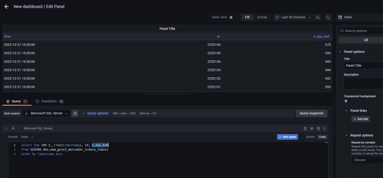

Hello, why realtime data showing in the time series panel is different and data showing in table is different. When i am executing the same query in sql server, it is showing same data as table panel but the data showing in time series panel and other panels are different. Can anyone help me to understand this?

Why the timeshown in table is different but the data is correct?
I have executed the same query in sql server the data is correct but the time is not in table and in timeseries panel it is not showing the data as per the timestamp

I figuered out the actual problem, my database has utc, and grafana is by default set to utc i changed, the default time as per my zone but it’s still ahead of my default time what should i do in this condition?
my local time is 5.30 ahead of UTC, i tried all the settings of grafana but it is set to utc only. So it was taking 5.30 ahead of utc so i reduced the time in my query and the issue was resolved but when i am trying to filter time it is not working can you help me out in it?
