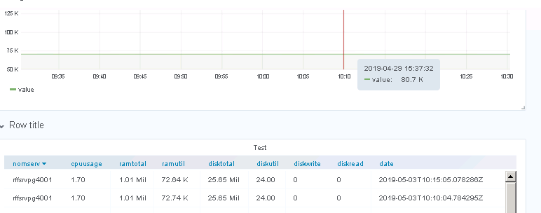

As you can see i have a value at 10:10 btu on the graph he tooks the old informations
You must always put the UTC timestamp into the database, not the local time.
Ok i will change my script and try whit the new time stamp and i will comeback to you.
Ok guys i got it, the timestamp dat i was using was without time zone and so when grafana makes the conversion he add the local GMT +2, but he dont have to because the time is already in GMT +2 so I have change my column type for Timestamp with time zone and now it work perfectly but i think dat if in you doe this it will works maybe $__time(date" +2:00") .
