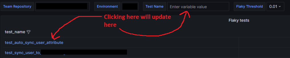

  • I am trying to update a variable on a dashboard called test_name with the value of a cell in a table when that cell in the table is clicked.
  • Right now I have a data link set in overrides that looks like this:
  • I have tried several URLs to try and update the test_name variable and can’t seem to get anything to work. The variable is listed at the top of the dashboard like this:
Am I taking the right approach? Basically, I want this:

The value of the Test Name variable is used in another panel. That part is working fine. If I copy and paste the value from the table into the Test Name variable it works exactly how I want, I just want to make it so we don’t have to copy paste and clicking on the test name in the table as shown above populates the test name variable.

OK, I have looked at data link. How does one fill out a data link to get this working? I’ve tried several things and nothing seems to work.
That said, I still want the field. I don’t want to just have the value be something that displays in some read-only capacity. I want people to be able to paste in a test name that is unrelated to this list if they want to.
