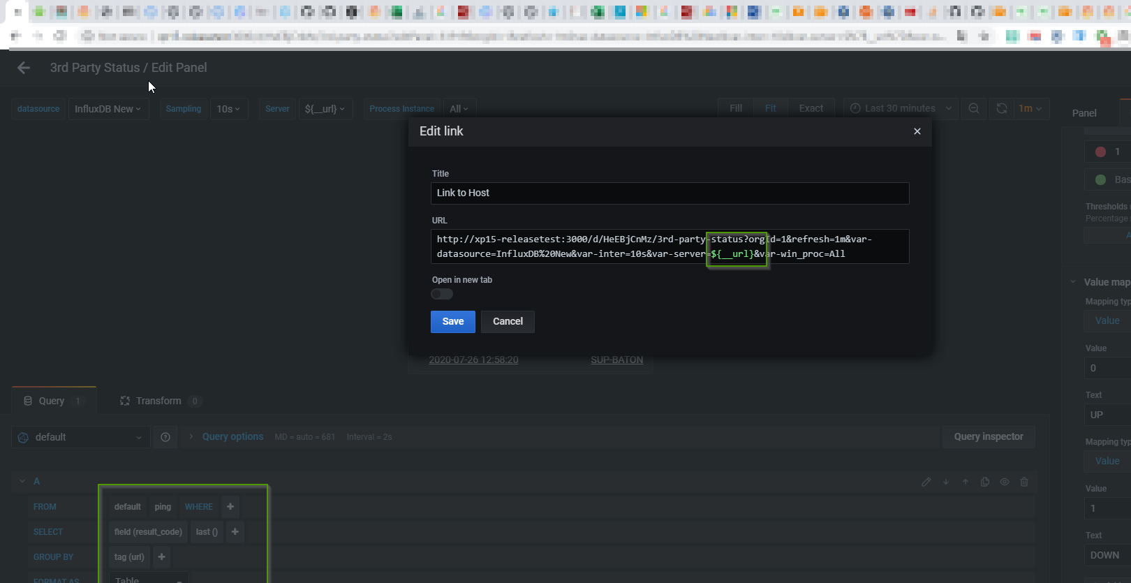

Hi All
trying to do somthing real simple (i think)
i want the table cell (CUBE-BS1), to be an hyperlink, so can press on it
that will populate the server var ?(QA-OLGA)
is that possible ?
Thanks!!!

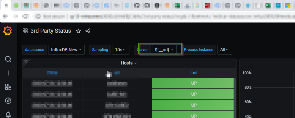

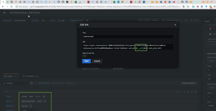

mm thanks it helped allot
i am able to populate the UI with just going to a predefined link
i am trying to use the tag so that the URL will be right but with no luck even after going over the docs
