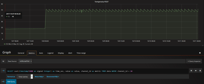

Can you try the following query:
SELECT cast(timestamp/1000 as signed integer) as time_sec, value as value, channel_id as metric FROM data WHERE channel_id = 10
Thanks for your new idea :slight_smile:
Grafana returns “no data points”.
If i use the querry in phpmyadmin I get a prettty nice result:
2017-10-18
I have no idea where the problem is…
For mysql the time_sec column needs to be int and the value column needs to be float. Can you see in the query inspector if any data is returned? Does your selected time range match your data?
