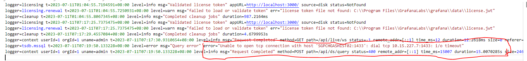

    No matter what number i fill in the input section of connection timeout, the result always 15 seconds timeout. (from Grafana log details)
Please refer to the following picture, in this case i changed the timeout to above 1 minute, it’s still unable to connect to database. I checked the log details. the timeout only 15 seconds which is not matched to what I set.

But you can see from my second screenshot, the connection duration only 15.007sec even i set it to 100 second which is not matched.
