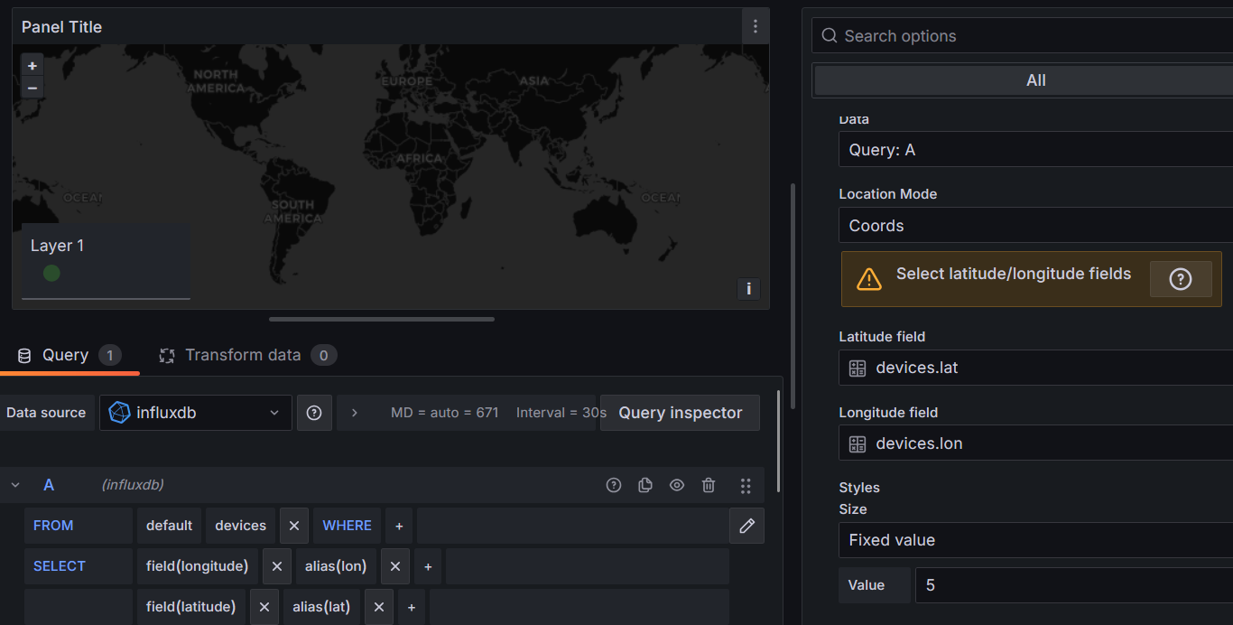

My problem is when I try to display it as geomap in Grafana : It only works if I fill lat and lon with the field “latitude”, as if “longitude” was not recognised…
With lat and lat, it works !
but With lat and lon, problem…
yet both fields are float… I use Grafana v10.4.2 (22809dea50)
I tried to modify each configuration field to see if there is a bug somewhere. I tried the “auto” mode to get coordinates, the manual mode, modify the aliases… I also did a “math(/100)” to be very sure that “lon” is recognised as a float, and it’s ok for this !
Update : Apparently, it is the problem of having 2 fields in my SELECT request.
If I remove my first field, the last one is considered. If I have 2 fields, the last one is not displayed.

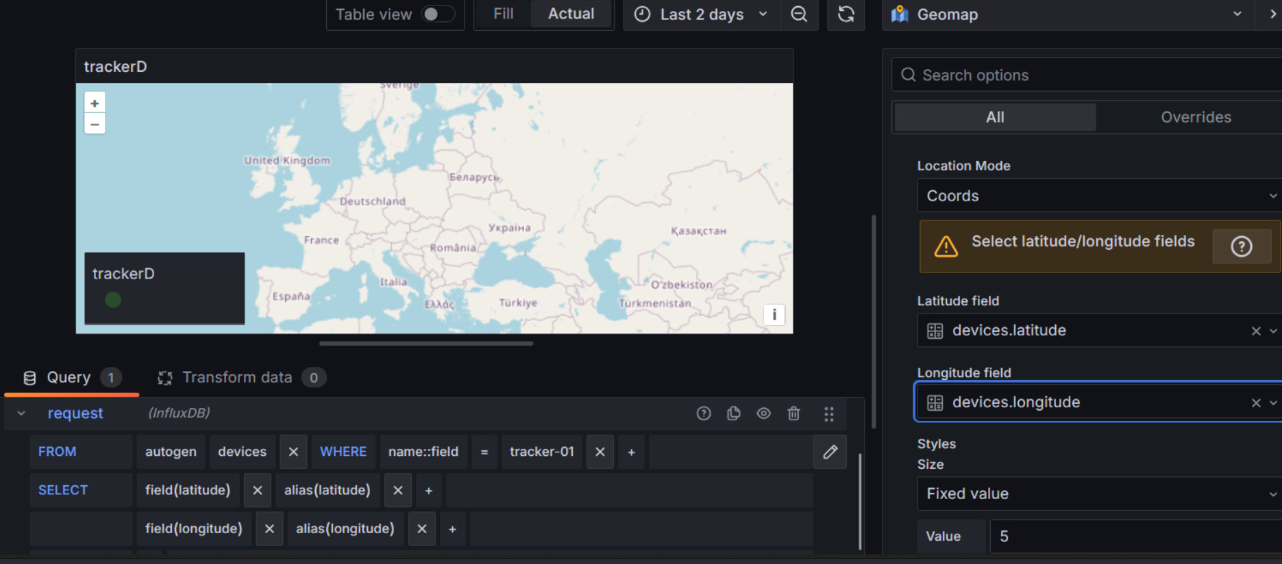

I updated to v11.1, but my problem is still here. Am I missing something ?

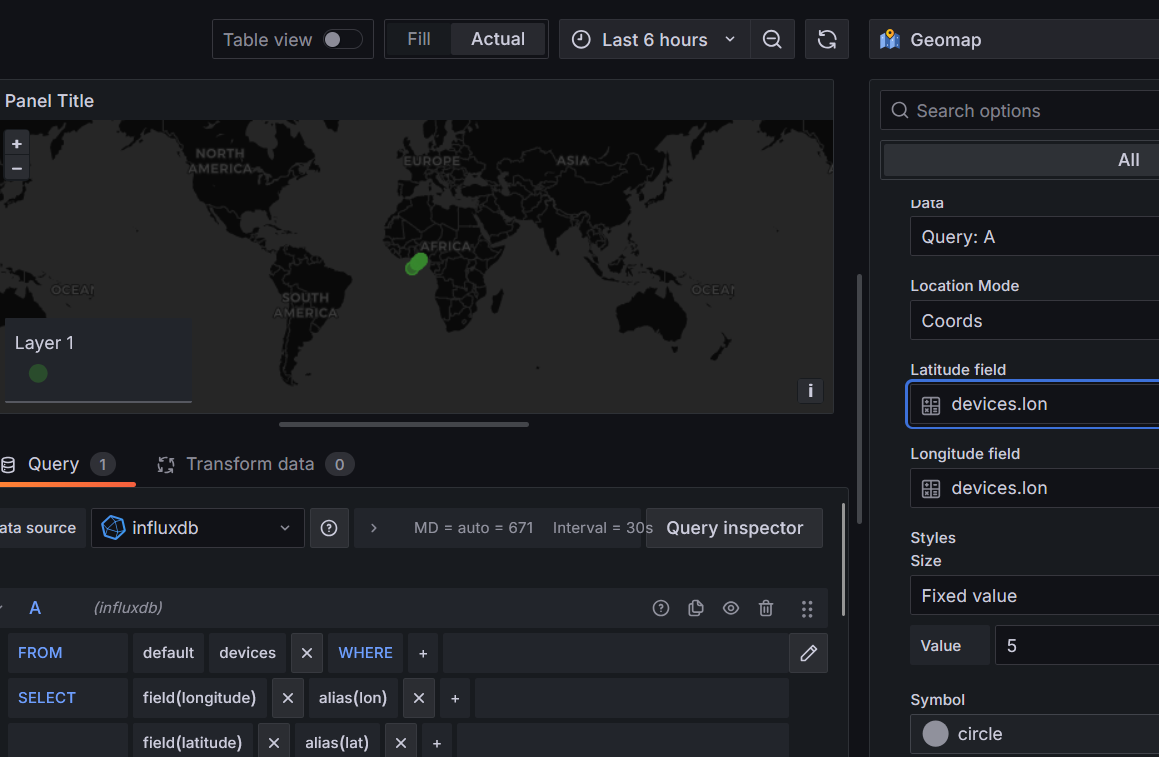

Sorry @yosiasz it was a test I did by renaming the columns in case of… Here you can see my data in dataview :
To be more clear, here is some tests I did :
  • when I do a request with field(longitude) THEN field(latitude), and when I edit the coord fields with Latitude Field → Lat and Longitude Field → Lon, it doesn’t work
  • when I do a request with field(longitude) THEN field(latitude), and when I edit the coord fields with Latitude Field → Lon and Longitude Field → Lon, it works (but nobody want this)
  • when I do a request with field(longitude) THEN field(latitude), and when I edit the coord fields with Latitude Field → Lat and Longitude Field → Lat, it doesn’t work (and nobody want this)
  • when I Change my request with field(latitude) THEN field(longitude), and when I edit the coord fields with Latitude Field → Lat and Longitude Field → Lat, it works (but nobody want this)
So base on that, it looks like the data is OK, but the 2nd field in the request is not considered… Is it more clear ? Sorry for my bad english !

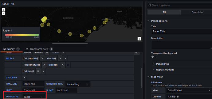

I finally managed to find a solution. In my opinon it was a bug of Grafana, that doesn’t take in account multiple “timeseries” fields in the request.
Here is the solution : format data as Table, not as timeseries…
